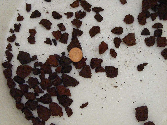

I have seen many people starting to use Lava Rock now but find information kind of scattered on the subject. I first caught wind of it with a post on column packing by Mash Rookie. I tried some in a 2" x 3' column that has a centering ring on an LM rig running on a propane burner. I broke up some rock that was for a gas grill and was a mix of red and black. I rinsed and boiled it a few times until the water stayed clear before adding it.
This is a sample of what I broke up. I believe I should have made it a little smaller. There was no restriction in the column what so ever. In the past with copper mesh I had always had it so there was a bit of restriction in the pipe blowing trough it. When doing a run of All Bran low wines with this size of lava rock I could not get above 93%. With this same setup and tight copper mesh I was able to maintain 95% at about a quart an hour. This is why I believe smaller tighter packed rock may perform a bit better.
My next build will be a 3". I would like to hear what others think of their experiences with Lava Rock to judge what size pieces I should run.
