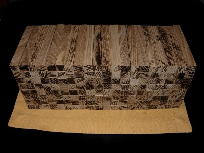

I posted this by request after sharing some of my sticks with wineo and from him, some aged spirits to mntwalker2.
This is my charred oak stick procedure with com observations.
I select White Oak from which I know the origin. I buy mine near Sonora Kentucky from some Amish fellow's sawmill. I try very hard only to get heart wood. I put them out in the weather, stacked with spacing between them to use for various wood working projects.
When they are good and dry, in about a year, the top ones have aged in the weather really bad and turned gray. These are the ones I won't use for wood working because they require a lot of cleanup. But, these have the best aging flavor. A lot of the water soluble volatiles have been leached out. These can give some bitterness in a long aging.
I rip these boards into 1/2" x 1/2" X 6" sticks either in my band saw or my table saw. It depends which one has less junk piled on it at the time.
I don't pay much attention to grain because sometimes these were the crooked boards or knotty boards anyway. That's why they are the cover boards on the stack.
After they are cut, I put 40 or so on the grating on the charcoal grill. I make two rows, with an inch or two between the rows and all the sticks in the row touching each other side by side.
I use my mapp gas torch with the instant start trigger. The mapp gas is so extremely hot that it can char the outside of the wood extremely shallow. It only burns about a 1/32 inch into the wood but chars it intensely enough that it removes the smoke taste and smell from the char. The wood immediately behind the char is caramelized. Since the char is carbon, and I char it until it turns bright orange, the resulting surface has thousands of micro cracks in it. These cracks are the alligator char in miniature. This gives much more area for the alcohol contact and allows the alcohol to flow through to the caramelized wood really fast. The intense heat is what allows this.
When I am torching the sticks I do the ends first. I hold the flame on the ends until they glow bright orange. and the wood grain is intensified. I then do the topside of the sticks working from end to end of each stick and preheating its neighbor. I always move slowly but constantly so that the surface has a chance to glow bright orange. The corners sometimes ignite but go out rather fast. I know I am moving about the right speed when I leave the corners smoking and sightly ashen. The I turn each stick 1/4 turn and do the top side again. By the time the fourth side comes around it won't need much to finish it off. I then bag them up for later use. I never wash them or pre-soak them. The char is as sterile as it can be.
The small amount of ash turns black in the spirits but is easy to remove. I always polish my spirits with a couple layers of coffee filter paper before final bottling anyway.
This process for making aging sticks is easy and rewarding. In 90 day with a ratio of two sticks per 750 ml or 10 to a gallon, it makes nearly a perfect sipping liquor. I have aged some as long as three years this way and the results are great.
Different liquors react differently with the sticks too. Wheat germ, especially the second generation, comes out dry after about 3 months. The fast fermenting molasses with no sugar added seems to pull more sweetness from the wood. It is really nice over ice. Sugar wash, especially the stuff that has been mostly cleaned up in a good column, approximates cheap patent still blended scotch. All wood but not much else.
The best proof for this wood is 120. The vanilla needs a bit higher alcohol but the water soluble caramel, especially the reddish part, needs water. I find that 120 proof is a real good compromise. Of course the proof can be fooled around with if you like. The more alcohol the dryer it is and the more water the more colorful it can get.
If you keep a lot of tails in your liquor, these sticks are a miracle worker. They can make a single run with lots of heads and tails taste almost like store bought stuff. If you like collecting everything but the foreshots, the these babies are nice to make harshness go away.
You know wood usually floats. In a couple weeks these become saturated and sink. Right after they sink, the mellowing starts.
These things are great in the smoker to flavor meat. Its second use is a family secret for pulled pork. Now you know why I weigh so much...

After an afternoon in my friend's wood shop, I finally have 160 white oak sticks per Pint's instructions. Some questions though. I bought a board of white oak that was as close to the heart as I could get, however it was still pretty much from the outside. Why is it necessary to get it from the heart anyway? Also, the board was 3/4" thick so I cut sticks with dimensions of 3/4"x3/4"x6". The change in dimensions shouldn't be an issue right? Pint, you say that you let your wood weather a good deal to remove water soluble nasties...should I soak my sticks in water for a while before charring them or they should be just fine?

sap wood has just that sap that is bitter not good and as far as aging"sticks" just leave covered but out in weather
( it will turn gray)
