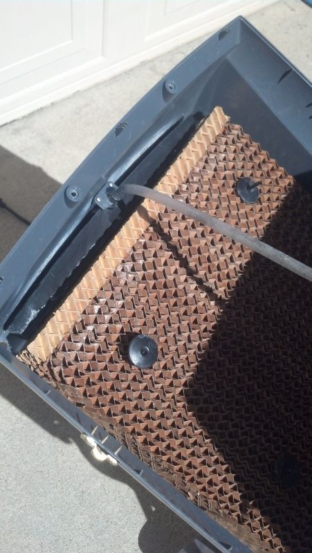

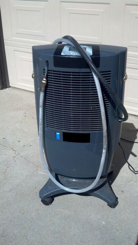

Standing in the shop doing some reloading and enjoying the blessed cool my find was putting out when I took a hard look at the still connections and inspiration hit. I dumped the recirc barrel and recovered the fountain pump, opened the swamp cooler and located all the water and electrical connections and went to work. This what resulted:

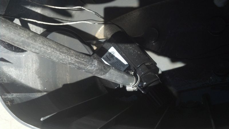

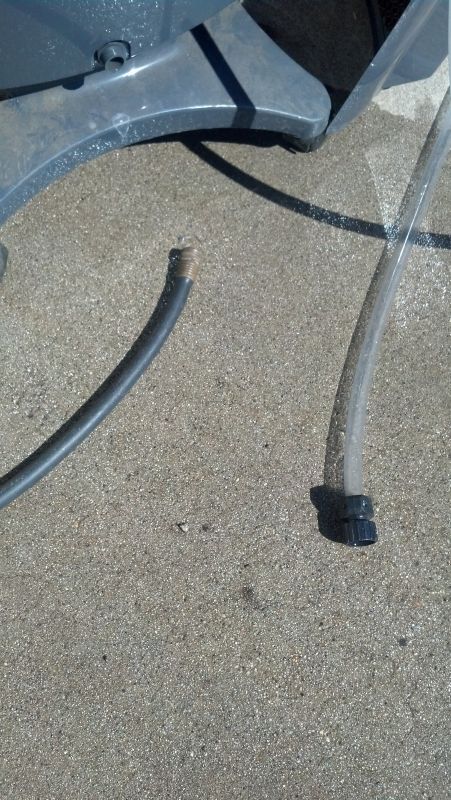

I pulled out the original dinky pump and replaced it with the submersible fountain pump leaving enough cord from the control panel and well clear of the high water level to reconnect the bigger pump with three simple connections for power. The black hose is the supply that goes to the pump.

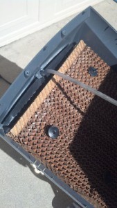

The clear is the return from the condensers that hooks to the top of the water curtain. I used clear so I could see the flow and regulate as necessary.

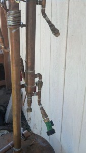

The whole thing hooks to the appropriate connectors on the still column.
