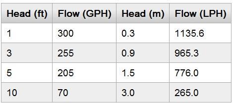

here is pump,,,i think i will up the tube to 5/8'' idCR33G3R wrote:You did say that it is reduced to 1/4 after the pump by tubing. how hard would it be to step the tubing up from the 3/8 or even keep it there to feed the liebig.
For feeding the liebig getting hose and fittings is fairly cheap. Just an idea.
the od of the outlet is 5/8''..id is 3/8

heartcut wrote:Centrifugal pumps will overcome outlet restrictions fairly well, but inlet restrictions (and buildup in the impeller vanes) shut them down. Your observed flowrate sounds really low.
i agree,,,i just put it in the sink..with a 6'' tube pointed down,,,so it will not splash.
timed it at 1 gallon per minute. that equates to 60 gallons per hour. it is rated at 300 with 1' head
http://screencast.com/t/JyspDlwgQghC" onclick="window.open(this.href);return false;" rel="nofollow
