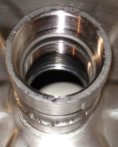

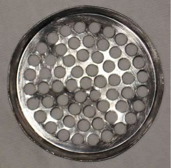

Most distillers use some way of making sure the mesh stays in the column:
http://i152.photobucket.com/albums/s197 ... tainer.jpg" onclick="window.open(this.href);return false;" rel="nofollow
http://i152.photobucket.com/albums/s197 ... houtMe.jpg" onclick="window.open(this.href);return false;" rel="nofollow
http://i152.photobucket.com/albums/s197 ... hMeshR.jpg" onclick="window.open(this.href);return false;" rel="nofollow
Column packing shouldn't have gaps between the sausages. Put them end-to-end.
