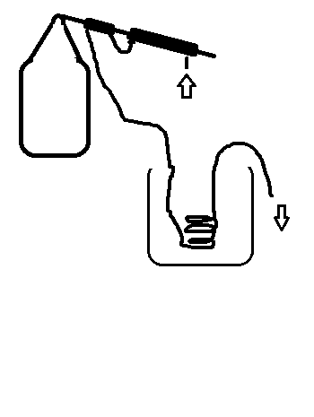

Plan B
If your condenser is too small and inefficient.
A small pre-condenser could be added for preheating the next batch.

- Posts: 10372
Re: Liebig condenser on pot still too small/ineffecient?
Genius Shady.
Waste heat reclaimation. I like it. Also reduces heat build up in a reservoir (recycle) cooling system, if you use one.
