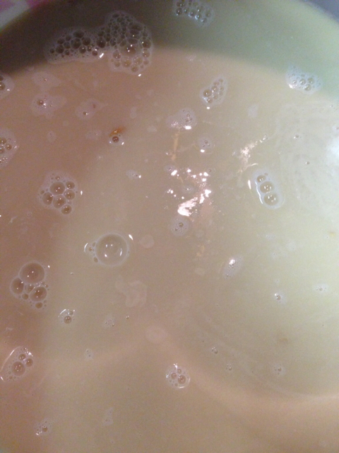

Is this clear enough? Oh well, I'm guessing no finning agent will clear this....

Kegg jam, just looking at that picture that wash does not look like it is done. Too many bubbles on top, and also still too milky looking. Patience Grass Hopper!!!!

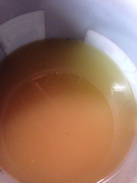

Sorry, poor attempt at humor. That was freshly squeezed Oats and Rye. Small experimental batch to test rolled oats straight out of the bag.OBX Phantom wrote:Kegg jam, just looking at that picture that wash does not look like it is done. Too many bubbles on top, and also still too milky looking. Patience Grass Hopper!!!!
Here it is after overnight sit.
