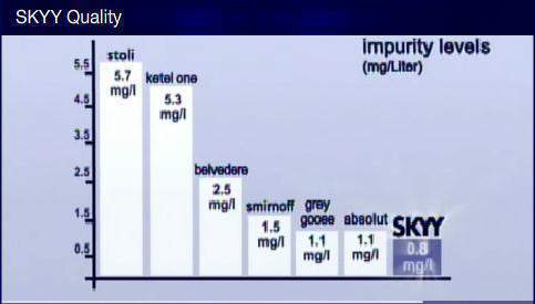

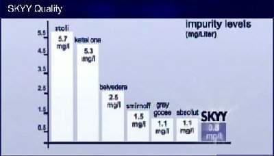

I had the same problem when I first got a column still. Just what is good vodka supposed to taste like? Well let me tell you it is hard to qualify. Like you I have a very well trained pallet from attending quite a lot of tastings for whiskey and vodka. Let me recommend a standard for you.
Skyy vodka is a standard flavorless vodka. < 1ml impurities per liter.
I had some reagent grade once that was <1 ppm but it was awful. To me ethanol and water has a citrus like quality. Therefore it mixes well with most citrus. You can detect the subtle differences much better when you water it down with a good quality spring water. Two parts water to one part vodka at 40% will show up any off flavors immediately. Some cheap vodkas are undrinkable mixed with water. They just plain stink. American brand sells a 1.75 L in a plastic bottle that I would have to charcoal filter to even be able to drink.
