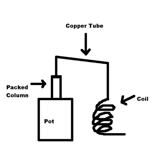

What would happen if you added a short (10"-18") packed column to a pot still with a coil??? Would it hurt or help anything? I sorta drew up an idea of what I mean..Obviously this drawing is far from exact but shows my general idea.Thx.
Dnderhead
Posts: 13666
Location: up north
Post by Dnderhead »
You would have a hybrid higher % than pot still but lower than
reflux ,most commercial whisky stills are like that

My potstill column is a hybred,and is about 18 inches tall,with 8 inches of 2 inch copper,and 8 inches of 1 inch copper with a leibeg condencer.It runs a little higher alc%,but only about 5% higher.I can run 6 SS scrubbers in the column to clean things up a little,or run it empty for full flavor.It works good for me.

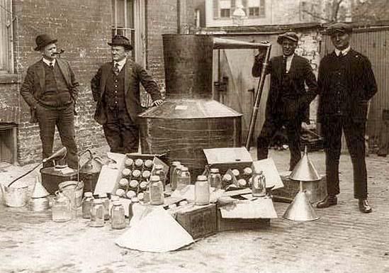

I have seen a LOT of pictures of old stills that look like this..I dont see a coil could someone tell me what type of still this would be considered and how it works?? I am assuming its a pot still but the copper line coming out is huge and as mentioned I see no coil??
Dnderhead
Posts: 13666
Location: up north
Post by Dnderhead »
IT is pot still Lye arm is tapered as vapors con dens needs less room
coil is not shone it probable worm in bucket Bigger still needs bigger
lye arm and condenser I could have fun with that!
BW Redneck
Posts: 775
Joined: Sun Dec 10, 2006 11:57 am
Location: 1000 acre farm, Ohio
Post by BW Redneck »
Them Revinoors bent the lyne arm in half so that it couldn't be used. Probably had to rip the coil off of it so they could do it. Kinking the coil wouldn't do, bending a new one is easy compared to soldering a piece of copper sheet into a hollow taper (I would think). Plus, it probably made a nice picture for a local newspaper back in its time.

The Largest still in captivity. ca 1922.
The photograph illustrates Lt. O.T. Davis, Sergt. J.D. McQuade, George Fowler of Internal Revenue Service and H.G. Bauer with the largest still ever taken in the national capital.
I don't think revenoors bent the lyne arm. From what I've seen around that downpipe went into a thump barrel, like in the pic below...
The flake stand is behind the thump barrel.
According to a post on the site where this pic resides,
"Billy was a still hand for an appalachian moonshimer. An hour and a half after making this picture the still caught fire and the shack where it was located burned to the ground."

nice pic but that to big four Anny thing iv ----Weill just too big
goose eye
Posts: 2846
Post by goose eye »
all that looks hard soldered meanin it wont ever took off the blocks much an aint sure they gonna take the time doublein they mite just be salein low wines. could of been made to run tween floors you leave the ketle on 2nd an just disconect everythang on first an hide it. probly runin it in a sand box so it aint gonna catch the house up. rekon they pour hot slops down the drain. some have a seperate septic just for that an got a honey diper that can get it gone when need be.
that other picture yall see them elbows with rags . hard to tell but you put your biscut on then rap with rag. gives somethin to push again. cant do it on cap
