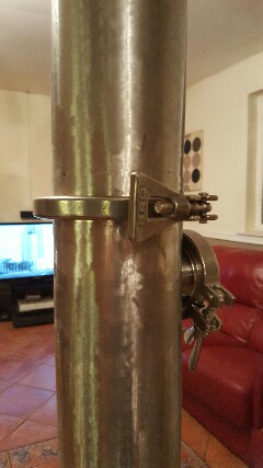

Its a reflux coil the picture shows the top section of the column. The vapours will exit from the section below this and yes i am going to run it as a pot with a thumper, but i have the copper to wind a coil so im basicaly just making it for future use while im waiting. The coloum is 4" and the copper is 10mm. I think im going to scrap the water and try salt.

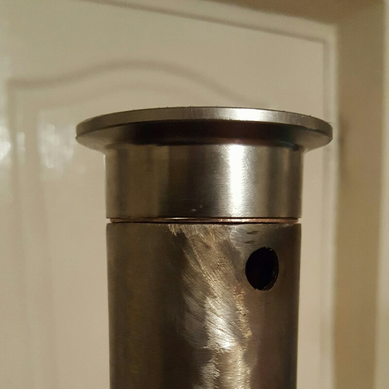

Welds
Welds
Well the simple shotgun is still a work in progress. Still stirring was spot on the steel was shite. I wrecked her pot for nothing :lol: And there's no flowers in it for her either. It should be finished this week i have heavier gauge steel now. Anyway i managed to get this condenser finished in the meantime.
Got my coils done, unfortunately it kinked so its not in one peice. But they work.
Some dodgy soldering...
More dodgy soldering...
Reflux condenser on coloum showing take off port.

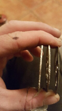

Made my new end caps today. Shotgun will be finished on Monday. Photo shows the difference between the new ones and that bloody pot. :lol:

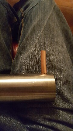

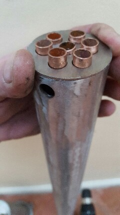

Finally got back to this today. Ended up replacing the plates again. This time i chose copper. I made 4 baffles to disrupt the water flow along its length, and then decided to try solder the ferrules on rather than have them welded.
The 2" pipe and the ferrules are 2mm thick steel so i made the end caps 1mm less than their outside diameter thus leaving a channel around the shotgun i hoped would accept the solder bed.
Anyway it didn't work. I've really got to order some decent flux. So ferrules getting welded tomorrow shotgun is essentially finished now. I just have to get a reducer for the bottom.
