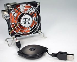

SR...the same here. Inside the "box" I hot glued the power supply to the side of the box where I had drilled out a spot for the plug.ShineRunner wrote:I made mine out of an old useless PC power supply. It already has a fan, case and 12V power supply included! I just had to glue the magnets to the fan and cut all the unused wires out. Added a cheap potentiometer from radio shack.. The flask sits right on top of the fan cage and works great! The distance between the flask and the magnets is a touch too much, so it takes some fiddling around to get the stir bar to catch, but once it does- it's solid.
SR
I like the "fan cage idea".... wish I thought of it. I bought long screws to adjust the height of the fan from the bottom of the plate. I then countersunk the screws on the plate so they would not interfere with the flask when it sits on the plate

I like the fan cage idea too. That fan probably has a little more power too.

Thermaltake makes a desktop USB fan..
You can cut out the center of the fan guard, gtlue on the magnets and use any USB wall charger and you have a stir plate with speed control for less than 20 bucks.
Staples sells the fan or you can find it on Amazon and the like.
