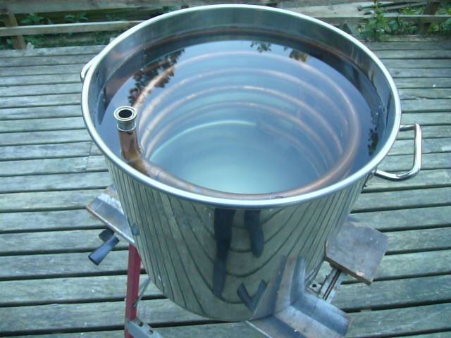

My experience with worm coil;
5 metres of 3/4" copper tube coiled into worm and mounted permanently into a 50L stainless pot (just so I have an easy to use modular unit).
Have a cold-in (at bottom)/hot-out (at top) and they just clip onto garden hoses with flow control on the end of the hose feeding-in.
Recent runs I have done I haven't had to start water circulating until over half way thru' the run (50L kettle pot-still/thumper running on gas flame with 10% - 15% washes).
I can run my hand up the outside of the stainless steel pot encasing the worm and past halfway thru' the run (while the water has still not been turned on) the pot is usually stone cold up to two finger-widths from the top. The mersion layer cold/hot differential is amazingly sharp!
Necessary water flow for adequate cooling is a dribble coming out of the run-off line. (Sorry - don't have actual quantity or flow measured, ... maybe something I do next time.)
When I first started running this rig 18months/2years ago as a complete newbie I wasted SO much water. After I got to grips with the process I realized the worm was a lot more efficient than I knew.
Main reason I went for the flake-stand/worm was I'm living off-grid and don't have unlimited power for running pumps and such over extended durations.
Water can also be a bit of a commodity itself around my place.
- rgreen2002
- Posts: 1309
- Location: Northeastern USA
Re: Worm question
That is a nice looking flake stand APD...real clean!
