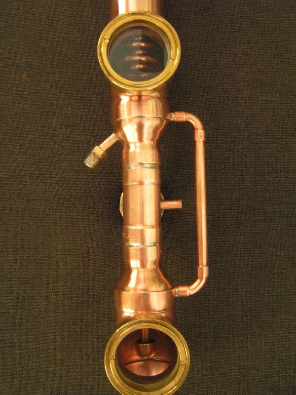

I have a sight glass on my 2" packed column but I have never seen it fog due to the onset of tails . I can taste smell the concentrated nasty shit starting to come through and it is as NZChris asked associated with a rise in temp . I used to start compressing tails but I don't bother any more as it usually only yield's an extra 250 - 400mls odd of not necessarily fine stuff anyway .
Yes if I let it rip , then the tails will come up and fog the glass but whats the point .Its nasty stuff that makes my packing and head stink .
I think perhaps a sight glass right at the bottom of the packing or perhaps a bit up , say 1/4 through the packing might give a fogging warning indicator but I still think tasting on the fly and or watching the temp are better detectors .
In the early days I did find the sight glass handy to visualize the reflux stream as apposed to how much product I was taking off ...IE get an idea of the reflux ratio .
I also was able to see things like the amount of reflux that was runing down the walls verses coming from the refluf return line .....not a biggy but interesting .
And it was definitely a cool factor and something to hold a bit of attention during a long 6-8 hour session
But to me the only real benefit of a sight glass came when I got a higher power element and got to the critical point where I was able to see that I was starting to flood and back the power down accordingly .
