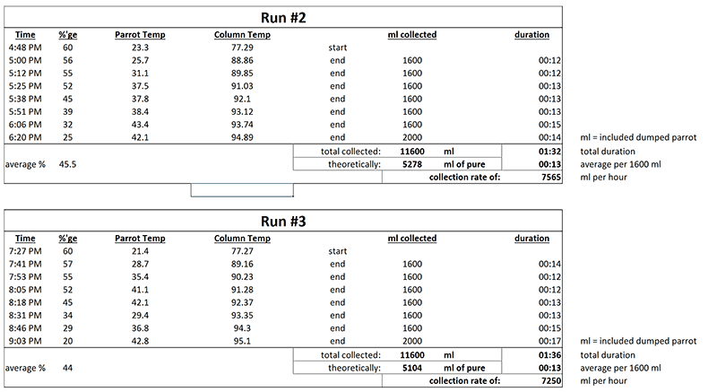

For stripping runs, using a 15 gallon keg, with about 11 gallons of mash at +-10% - birdwatchers recipe which worked perfectly.
Had a buddy help me build a 1/2" inner, 3/4" outer by 36" long dual liebig which I can swap onto my 4' x 2" stainless column.
Yep, zero problems knocking down from a 4500 watt input. I was pulling off 60% at the start, down to 15% at the end
And it was flowing nicely at 1600ml every 12-13 minutes, and I took about 8 jars from each batch. I was able to process 3 batches yesterday in about 6 hours.
Reflux with a nixon/stone head will be next, as I now have about 10 gallons at 40% to work with.

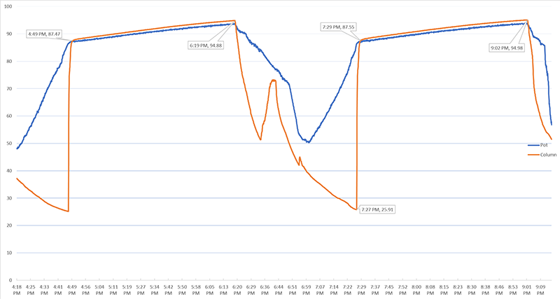

Compiled the data from 2 of the runs:
chart of 2 runs
chart of 2 runs
Chart of the pot temp & column temp's
Chart of column & pot temp's
