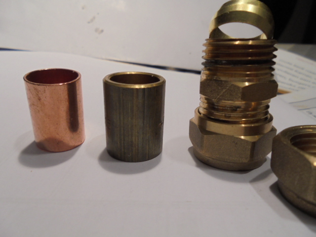

Left: copper, wall thickness 1 mm. To be soldered.
Middle: brass, wall thickness 2.2 mm, in the middle there is a rim of about 1 mm. To be soldered.
Right: brass, in the middle a rim of about 1 mm. To be compressed.
Edit: there might be on that must be soldered on one end and compressed on the other, but I am not really sure about that.
(I can not upload these picture in a pm. Sorry!)
