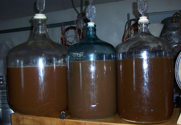

This is an example of how much head space I use at the beginning of a ferment. That is a 12 gallon carboy with 8 gallons of juice and 2 five gallon carboys with 4 gallons of juice.

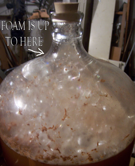

This is a picture to show how much these foam up. It's hard to see but it came within a couple inches of the top. If I had 1 or 2 more inches of juice it would have filled the airlock and overflowed or blown out giving the fruit flies a chance to ruin the batch.
My normal procedure is to start off with lots of head space then after it settles down adding more juice until there is about 2 inches of head space. If you overfill you will either wind up with an airlock full of apple foam or blown completely out of the fermenter.

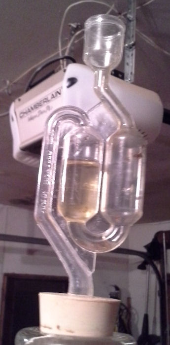

I seldom take an SG reading after the initial one because I figure it finishes where and when it finishes and whether that is .999 or .995 is largely irrelevant to me, when it sucks back it's ready. Often I will let the finished cider rest for a long period of time. I'm in no hurry so it may even go close to a year provided no infections show up. If an infection does show up I will run it as soon as possible. Normally left undisturbed under airlock it will sit there patiently for as long as I want to let it.
