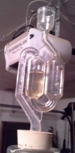

This is a picture to show how much these foam up. It's hard to see but it came within a couple inches of the top. If I had 1 or 2 more inches of juice it would have filled the airlock and overflowed or blown out giving the fruit flies a chance to ruin the batch.
