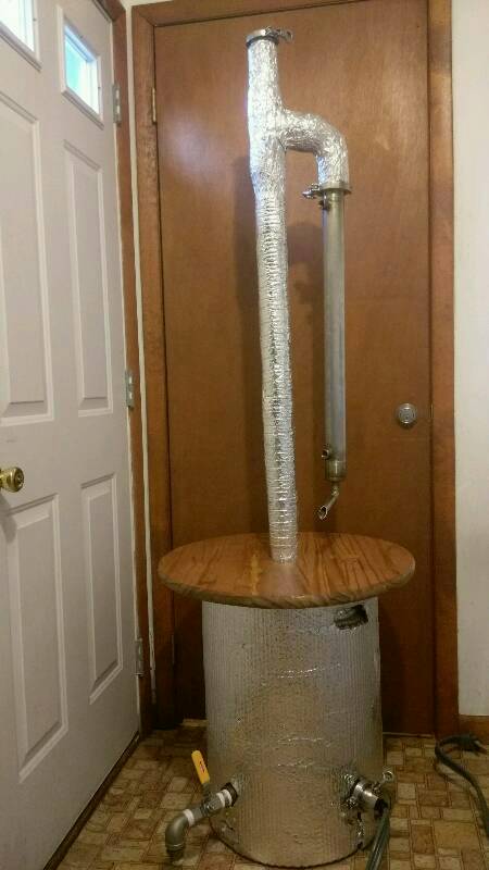

I see what you did there. I guess there is a small chance I would like to do neutral spirits in the future. A few things about this though, one I have to have a taller column now which = $$$ in copper. I had considered a modular build that would allow me to do that later. I'll have to think on that.
The other thought, and maybe my theory is wrong, but the taller the column, the further from the heat source, the more potential reflux? And what happens to the alcohol vapor that is in the top part of the T? Reflux?
If my column isn't as tall as the one pictured, then I need to extend my column further out. That way it can be long enough to do the job and not run into my keg.

There is no reflux because of column length. It will all exIt through the t. I don't know about you, but I can only get sticks at minimum of 5'. Bottom line is, if you want a vertical shotgun at almost 2' to land at the length of the top of your keg, then there is no way around going to at least 2' in the riser. If you want a lebig, then there are ways to shorten it.
I guess my point is look in that thread and see what my original design was, and how much less copper I used with the new build. Build it right the first time, and that is the best way to save those $$$ in the long run. Even if it is a little more up front.
2' 8" up, 4" for the connection between outlet and 90, then 2' back down for the condenser. Lands on your keg top. The neutral aspect is a secondary benefit that will cost you nothing later.
Just a thought, and only one way to think about it. Lots of other great build around. :thumbup:

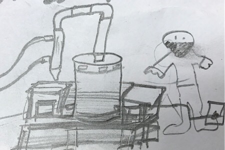

It’s a great build and I have some thinking to do. Certainly worth consideration and the kind of input I was looking for. I have attached an “artistic” rendering of the design I had in mind with the table. Adding some storage, a place to mount temperature gauge and a way to tuck some wires and things away. Not to scale and I’m not responsible for any harm or damage created by this design.

Why not mount your shotty at an angle? It will be more efficient, and make it easier to hit your collection height goal. Usually done just by building like your drawing but using a shorter horizontal piece with a triclamp in it. The clamp can pivot to any angle desired, and thus any height desired.
