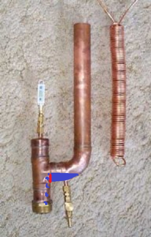

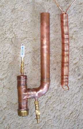

I'm looking at building a reflux still with a condenser copying this design.
My question is, with the vapours travelling past the ope needle valve to condenser do I lose any vapours out of the valve. Also with the condensed alcohol coming down and out of the valve won't it mix with the vapours going into the condenser and if so will it effect the end product?

There will be a Dam or resoviour ( see the Red thing in my pic) that the condensed reflux ( the blue stuff ) builds up behind .
You take off a small amount , typically about 10-20% as product via the needle valve , the rest overflows down into the packing . Thats how a reflux still works .
So no there shouldn't be any vapour that can come out the needle valve as it should be sitting below a pool of liquid.
The only exception might be if you are using it as a stripper in which case you would have the valve wide open so that all the reflux comes out the valve . . Interestingly I have wondered about that myself . A product cooling condenser would fix that problem and also cool the liquid during reflux mode so you can use a parrot if you want . Just as a side note . That Brass needle valve is almost guaranteed to have lead in it . Just say'n .......Modern domestic plumbing brass is mostly lead free but things used for fuel lines and air lines is not ....just be careful
