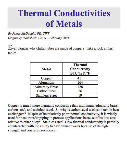

The biggest drawback of the liebig is the length needed to work. Despite the increased cost and complexity to build a shotty, this has to be the primary reason 'stillers go the extra step to do so.Kareltje wrote: So indeed: why copper in a Liebig?
There may be a liebig here with a stainless steel vapor tube, but the heat transfer coefficient between copper and stainless is quite compelling.
