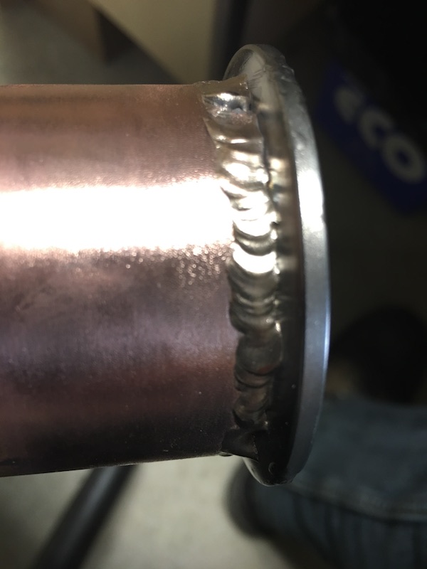

I tested a weld for leaks tonight and.... Ok got to buy a few more ferrules as I need to practice a little bit more.
I was not confident at all on the first weld, seemed really crappy.
I never did silicon bronze, and flowing is not what I thought.
Will try to post pics tomorrow as I left parts at work.

Are you tigging it? If so what is your procedure?

Yes I am tigging copper and stainless with silicon bronze rod, it's considered like brazing.
I do like I learned: backflush with argon, direct heat more on copper because it dissipates more heat and try not to do bubbles
I'm not that good.
If you want to see really neat work, check this thread of VictoryRay viewtopic.php?f=17&t=69691
He did a really good job.
I'm not that good.

What kind of tungsten are you using? Sharp tip or slightly blunted? Did you clean the living piss out of both the copper and SS? If you pre heat the copper lower down as to not oxidised the preped joint it can help allot. Do you dip and move or do you like to lay your wire down and wash over it? I prefer the later.
Edit to ask: did you clean the silicon bronze as well?

I use lanthanated as per what the welders told me at the shop and it's sharp tip.
I cleaned the copper with a wire brush and I sanded the stainless to rough up the surface a bit.
I also cleaned the bronze rod with scouring pads as there was some green on it.
I did not preheated the copper at all.
I put some aluminium paper inside the copper pipe and made a cap on the ferrule to keep the argon gas inside.
I tried to lay the wire and heat it and also dip and move but I prefer the first one.
I just feel that the 3/32 is a bit too big. I'll try some 1/16.
This what happened, and I must improve
I also must remember to cut the power at the pedal before moving the torch away ! It's not mig... I did wonderful arcs that can be seen on the stainless ferrule. I'm no way professional welder but I have help from welders at the shop.
I could have them make this, but I want to learn and succeed by myself

You gotta walk the cup to get proper fusion of both base metals. It looks like you are cold as well, try bumping the heat 5-10 amps. I never did care for the lanthanated, I was partial to thoriated for most things. I will tell you what not to use, pure tungsten, it is only good for like 15 amps or something like that and it balls and spits.

Thanks for your advices pfshine
I'll train again and again !
