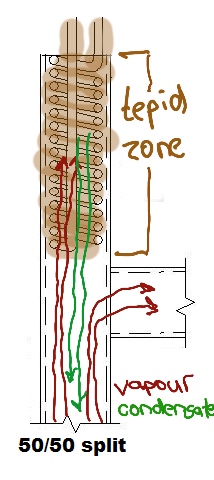

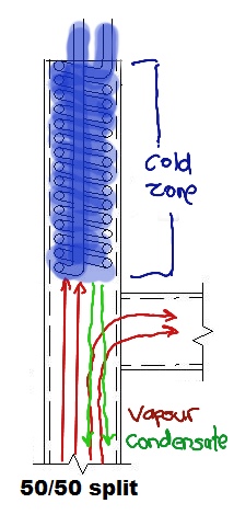

What amount of water temp variation are you picturing? Your scenario would work on a CM but not on a CCVM unless the cooling water becomes boiling hotshadylane wrote:Based on my limited experiments with CCVM, I'll have to disagree.![]()
Picture a CCVM at mid run. Raise the input cooling water temp and see what happens.
The reflux ratio, and ABV will decrease.
In my scenario the bottom of the RC is well above the top of the offtake. As long as that RC is cool enough to condense the vapour then all things being equal (diameters of column vs offtake) 50% of the vapour is exiting via the offtake.
Think of the RC as a moveable bung of coldness, no vapour escapes as long as the bung is cool enough to condense the vapour. If the bung gets too warm then vapour gets lost to the atmosphere and of course reflux ratio and ABV will decrease

Sorry, I still don’t get it? If the cold zone becomes a tepid zone the vapour just travels higher up the RC but it still condenses -just higher up.
If you’re not losing vapour, you have enough HETP in the column and getting reflux without flooding then I can’t see how the temperature of the RC cooling water has an impact on ABV?
I am not saying you are wrong Shady, I just can’t get my head around what is causing the changes you observed.
