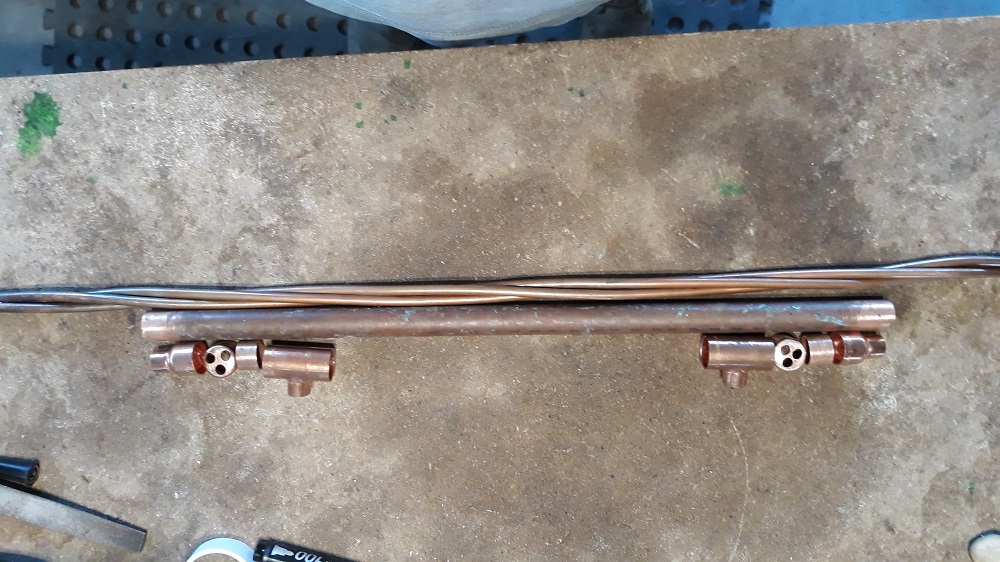

Ive made a shotgun style condenser at 19mm/3/4" outer tube.
Here are the parts.
2 tees,2 sleeves, 2 reducers,i length 3/4 pipe, 3 lengths 1/4 pipe(twisted) and 2 caps with 3 holes drilled.
i luv makin booz.

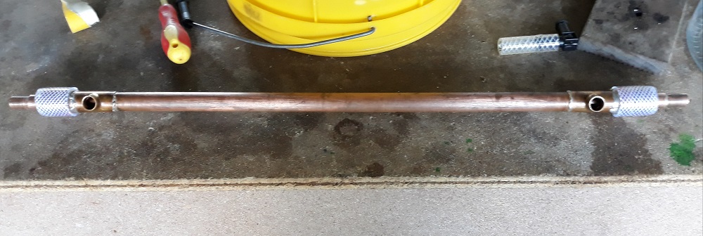

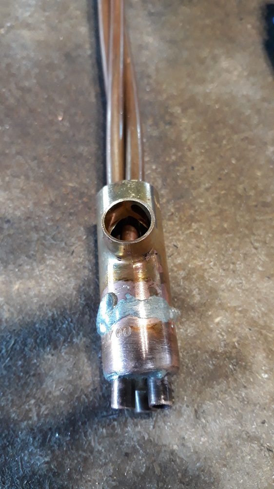

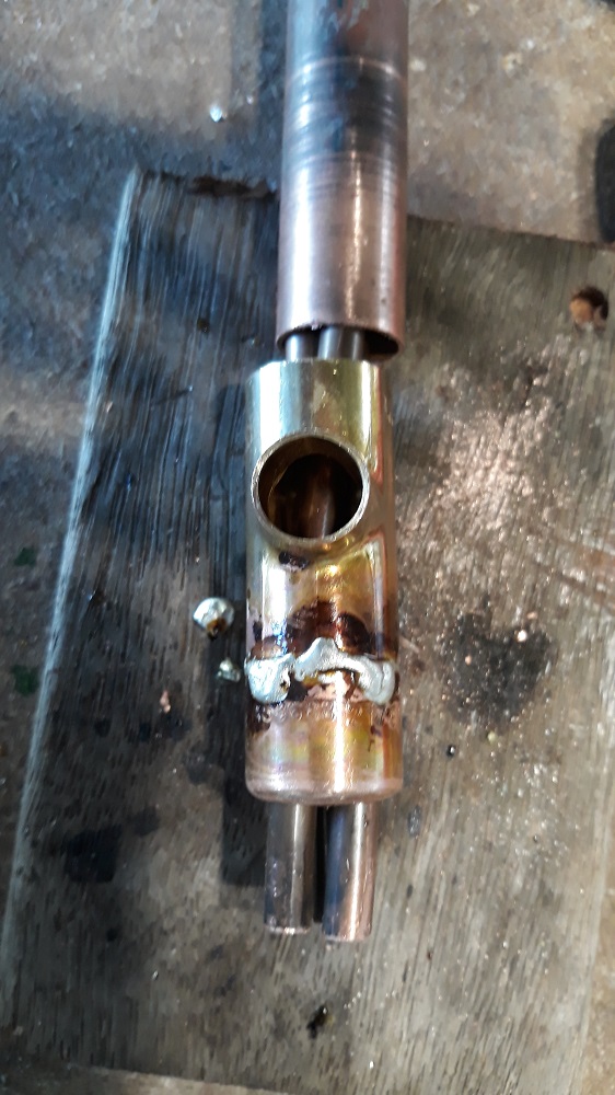

i luv makin booz.
