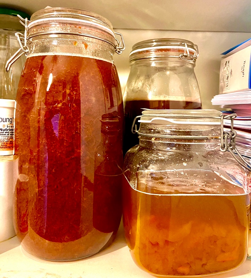

That link was to show the ss filter over just the coffee filter. I’ve got 3 L of vodka over strawberry jam and wanted something to filter out the jam. Not interested in the carbon side. Also 3L of vodka over marmalade.

Just use coffee filters, let it sit for a week or so, then rack it.. there is no other way around it, it's just the nature of the animal you are dealing with..
That's what I do went I macerate stuff..

Or get/make a buchner funnel and a venturi.

I had a look for SS stuff and couldn't find much. I just bought this and combined with a plastic venturi, you run water through it and it makes a vacuum, MAGIC! I'm planning on using it with coffee filters.

You could check lab supply places. There's a dutch firm that sells refurbished and used equipment.
https://s-a-le.nl/nl/product/afzuigerlenmeyers/
Perhaps there's something similar near you.
Or you can befriend a welder

I use some fiberglass milk house filters from a farm supply place. They’re about a 6” round. Just fold em into 4ths and stick the cone into a ss funnel and they’ll take out the big stuff (large ash bits, small wood bits, dust or other debris that happens to float by) and always a good thing when bottling for the odd fruit fly that thinks he’s gonna take a little nip while I’m transferring.
They aren’t very fine so they don’t impede flow or get stopped up easily. They will easily permit small ash dust to pass. It doesn’t hurt anything but when it settles it looks bad.
If you want something finer it works well to put a coffee filter liner in the milk filter. This keeps the filter from sticking to the funnel and provides a flow path through the entire coffee filter surface as a permeable support layer.
You could also just rely on decanting with the help of a floc agent like bentonite. Mix up a little as a premade slurry and add a couple spoonfuls to the jug you want to settle and stir it up well. In a few days it will have settled completely to the bottom and be much more resistant to be kicked up again if you pour it off carefully through a basic filter. It will clarify nicely without affecting the flavor or color of the spirit. You can even reuse the sludge into another jug and even several times over. At the very end when you don’t want to save it any longer just rinse out the sludge into another distillation run. Bentonite has the added benefit of removing many haze causing agents the come over when aging on wood that are otherwise impossible to filter. They may be harmless and tasteless, but darn it!, it just seems to take something away when there is a bit of turbidity in an otherwise great looking spirit!
