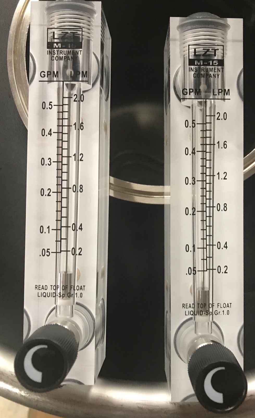

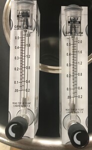

I was wondering if others monitor the water flow through their reflux condensers. I have a couple meters that I will post a pic of that I was thinking of using. I was thinking that with the power input data from my controller, water flow into my and out going water temp I could start to understand my column better. Maybe that info would help me connect the dots to what I am smelling, seeing, and feeling while running. Have any of you found any value in doing this?

Thanks for your reply. I checked with a beaker when doing my sac run and it looked like I was using about 1 gallon every 4 minutes for full reflux. I hope the gauge will give me more accurate info while taking product during a normal run.

Thanks for the input. I was hoping to use all the gathered data points ,input kw,water flow,and condenser exit water temp along with product output to try to get my runs of the same beer stock more consistent.

As a quick update I did get a chance to use the water meter/valves I posted a pic of. Two runs same feed stock in boiler and the repeatability was great. Just wanted to let others know they worked well. Should work well for anyone as long as there condensers don’t use more water than be metered.
