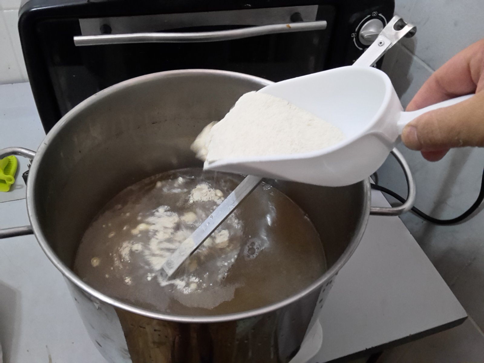

There are a few posts about this yeast, and I myself am doing tests (with flour) to prove this ingredient. I did some fermentation tests by simply adding water, flour and this yeast without going through the heat of a classic mash but I am not very satisfied with the aroma .. So I wanted to experiment with something very different.
Amylase enzymes are also in the ingredients of this yeast mix, I thought I'd put them to the test. Although I never use enzymes, I thought it might be an asset on occasion, the more you know the better.
IMPORTANT:This is nowhere near scientific proof, mind you, it's just a home test, nothing more. I will illustrate step by step what I have done.Despite having a continuous motorized mixing system that I use for brewers, I intentionally used a very basic approach, treating enzymes a little bit badly.
First test: a direct mix of yeast and flour without doing a pre-gelatinization.

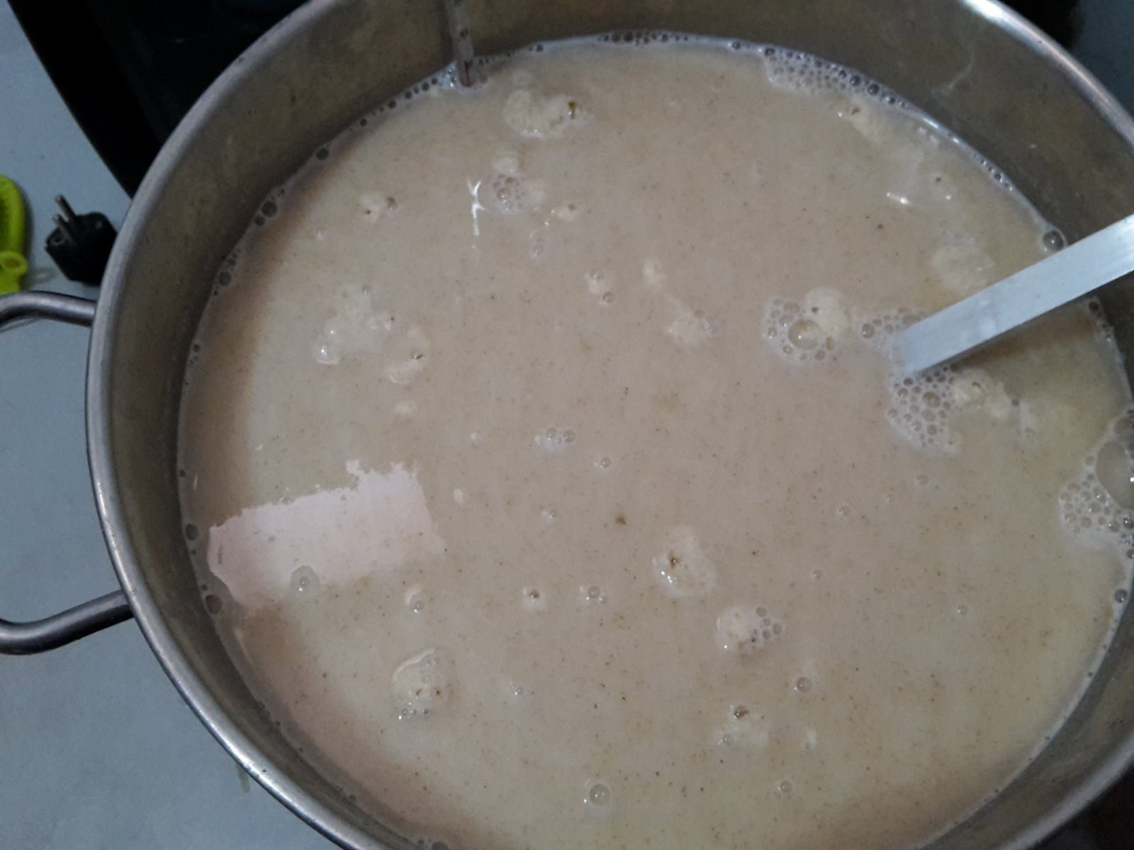

The temperature was slowly raised to mash a temperature and maintained for a few hours but this first approach was not entirely satisfactory, no conversion acceptable.

At this point I thought of raising the temperature to gelatinize the starches well, then cool to 65°C and add more Angel yeast.
After a few hours' saccharification break (in the meantime I did other things) I did the iodine test again and this time it was positive.
