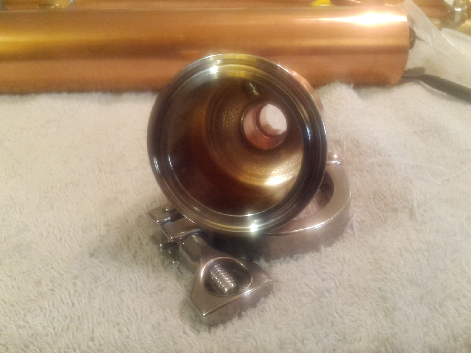

I know it doesn't help a lot but I made this out of a 2-inch to 3/4 reducer with a 3/4 to 1/2 reducer. It was a lot easier to make than you may think. Before anybody says anything yes that is a plastic funnel it was a cleaning run and no I do not use it anymore.

Sailman wrote: Fri Oct 09, 2020 9:50 am I know it doesn't help a lot but I made this out of a 2-inch to 3/4 reducer with a 3/4 to 1/2 reducer. It was a lot easier to make than you may think. Before anybody says anything yes that is a plastic funnel it was a cleaning run and no I do not use it anymore.
Intriguing pics of the build...any better shots of it I'm planning a new keg and looking at others pics helps

Anyway here is how it was made. I purchased a 2 inch to 3/4 reducer and then a three-quarter to 1/2 reducer. this was soldered together with stay Brite solder and liquid flux. Then I used a 2in sanitary fitting. The 2-inch fitting is going to be too small to fit the 2in reducer. So what I did was take a short piece of 2in copper pipe and sanded the inside so it would fit around the 2 inch sanitary fitting. Then I tinned the sanitary fitting and slipped the copper on to the fitting and soldered that together. after all of that was completed of then slip the fitting into the reducer and soldered it together. I got the idea from a thread here but right off hand I don't know exactly where.

Here is a picture I borrowed from Twisted Brick and his thread on the easy 2 in shotgun build. I think this is where I got the idea.
IMG_1873 copy.jpg (13.09 KiB) Viewed 3439 times
On the left side of the picture you can see what I was talking about making the spacer for the 2 in fittings.
