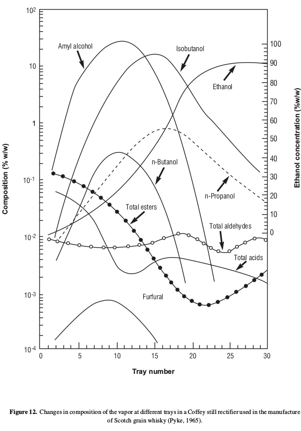

Assuming you mean methanol, I doubt you'll get any effective separation there, it tracks ethanol pretty well. Are you distilling fruit or something to have enough methanol to worry about? It's pretty much the hardest congener to separate, with the least need to.Evil Wizard wrote: ↑Fri Oct 23, 2020 2:32 pm If I can do cuts on the reflux side, ideal. If I can just do meths cuts, that's fine.
Doubt that. You seem to be thinking that distillation separates substances by their pure boiling point rather than their relative volatility. At best some of the fusels are somewhat building up in your stripping column and any that are will eventually build up enough to come over eventually anyway. All fussels are much more volatile than your bottoms stream so they aren't going out there. So a steady stream of low concentration will come over with your 40% while the rest will build up in the stripping column until it crowds ethanol out and eventually comes over in a rush (this happens sometimes even in the giant scotch grain distilleries, and it not only upsets the whole column, but tends to rush right out the top when it happens). Like methanol (and everything really) the other alcohols don't separate by the boiling point of the substances, but by their relative volatility in the mixture, which is driven more by polarity, functional group and mw than bp.All the fusels fall out of the stripper anyway.
Pumping back to the first column is the classic solution going all the way back to the Coffey still. LWTC's solution to periodically recycle it to the wash feed indirectly accomplishes the same thing because that's where the wash goes. As does his option of just running in cycles that allow it to be saved and dealt with later. Note he shows a 200L reboiler and says it needs pumping/draining about every 6 hours (that probably isn't a full 200l capacity, but close enough for hand waving). I had guessed your 30L reboiler would be overflowing in less than an hour.... 200l / 6 hrs = 33.3 lph If his system runs similar flows to yours, yours will be full in just under an hour. I can't really tell from his pic, but if that's a 4" column he's showing, I bet the flows are similar seeing as how he mentioned 1000L wash per shift on 4" in his previous post which is pretty close to your feed rate.The bottom of my reflux column would be a u shape like my first column. Water falls past the heaters goes sideways and up a short column where its cooled and drops out. I dont see why I'd pump it anywhere, it's just hot water. On the strip side there's lots of it, on the reflux side - far less.
If there is enough alcohol still in it, I'd use it as backset.
Of course your systems aren't equal, his is a thumper fed with vapor straight from the stripping column while yours is more like running 2 stripping columns in series than a conventional dual column still. There's mathing that could be done to predict performance, but I have a feeling you're going to build it anyway and find out for yourself. That's cool you might learn something to teach everybody. It will be interesting to see how yours behaves at the bottom.
But if you aren't allowing some way to make "cuts", it won't be very interesting to see what comes out of the top of it, it will just be high proof low wines which will need to be re-run in a batch still to make cuts. Continuous distillation isn't a magical process that dumps all the funk down the drain. Side draws and venting the most volatiles are the basic ways to make "cuts" continuously.
Here's a pic to give you an idea where congeners concentrate in a column, and where they must be removed. Note, if you don't remove them, they just build up and come over anyway because a column only has so much holdup. If you don't allow ways to draw them off then as you can see most everything will end up in your final distillate. In which case you could save yourself the trouble of a second column and just make your stripping column a wee bit higher to get the same high proof durty.
