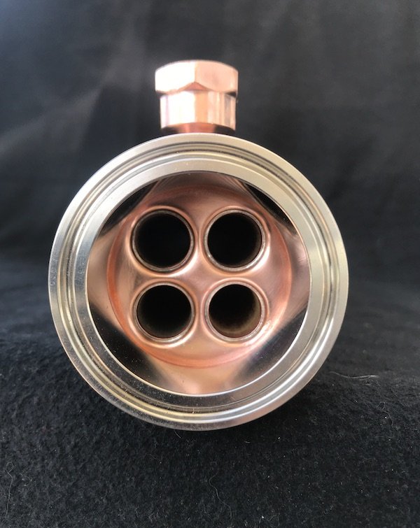

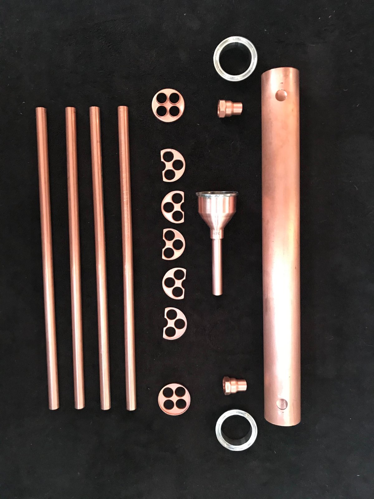

If you get the stainless shotgun condenser, make sure you have a ferrule welded on each end. If the output end comes with a collector, you'll only need a ferrule on the input end. Your decision to go with a copper shotgun (whether you build or buy) would be sound. Like ezlle71 mentioned, stainless steel has about 3% of the level of conductivity of copper and is not ideally suited for a condenser.
If you would like information on end plates/baffles, a complete kit, or a complete copper shotgun made for you, please PM me. Here are a few pics of shotguns I made for members in December.
