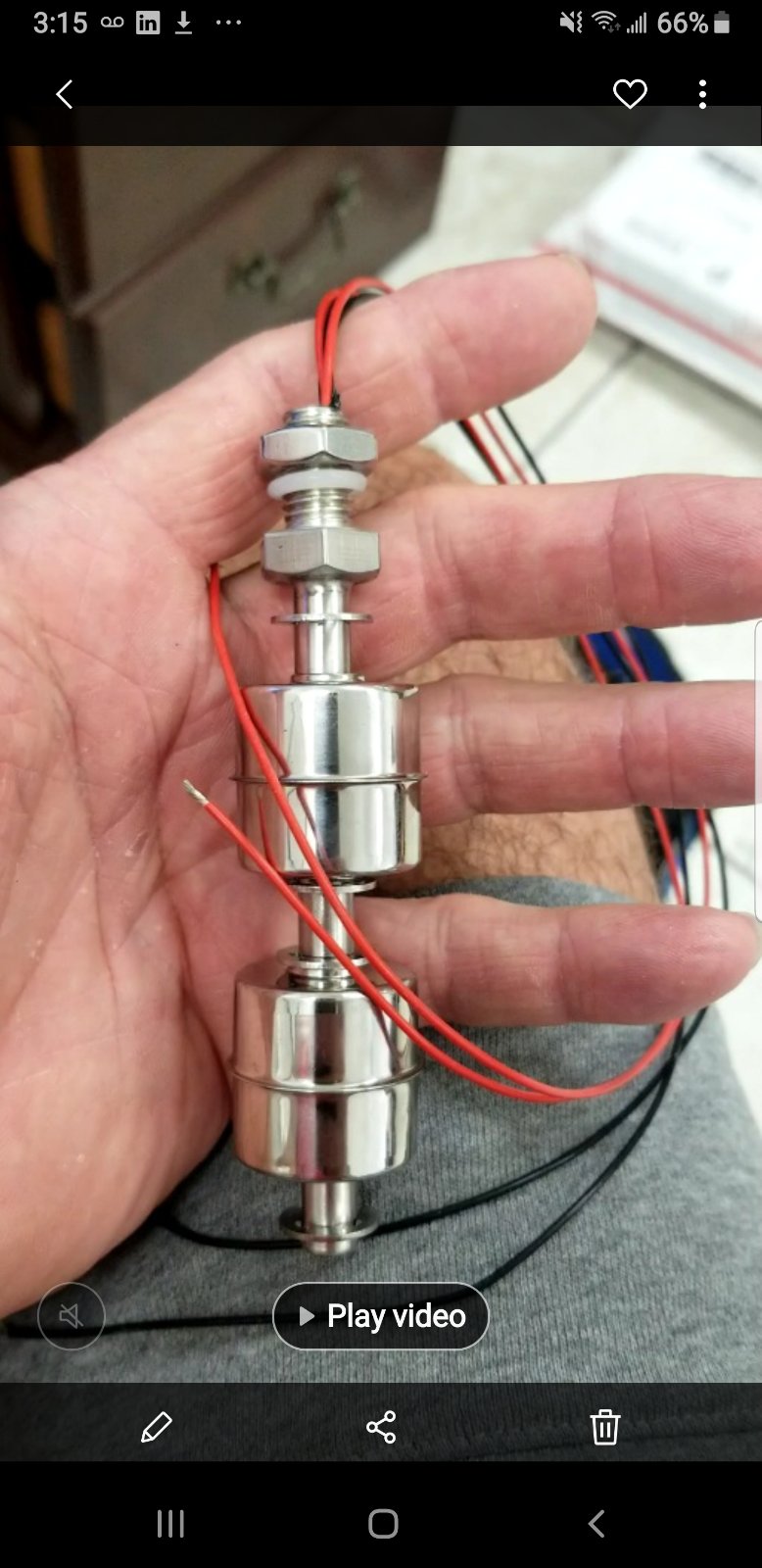

I have a side canister off of the main boiler.
There is a cheap 24V SS float switch housed in the side canister. The side can keeps the floats isolated and prevents the floats from being too agitated by the boil. The travel on the floats is very minimal so as not to introduce an excessive amount of replacement water and disrupt the boil.
The replacement water is provided by a 24V solenoid.
This allows the steam generator to run indefinitely, without interruption.
The replacement water also enters into the side canister to allow for the newly replaced water to temper and reduce the likelihood of disrupting the boil in the larger canister.

d) Drain the waste distillate into the boiler and have an overflow at an appropriate level in the boiler that has a p-trap to prevent steam from escaping. Might even be able to just have a port near the bottom and elevate the pipe that is attached to the port. This would have the added benefit of helping to recapture alcohol that may not have been totally stripped from the beer. The heat for the overflow water could still be used to heat the beer going in.tiramisu wrote: ↑Tue Feb 16, 2021 5:29 am ...
a) The simplest solution is to stop and refill
b) Next might be to add water already heated to the system. (pre-boiler).
c) Next is to provide the amount of energy required to bring the additional water to 100C as it is added to the system with exactly the right amount of power almost instantaneously. ...
