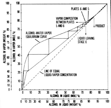

These charts may help understand what you need. By my quick read of the second one you would need a 85%+ charge on a single distillation to get 90% output.
/forum/download/file.php?id=54017&mode=view
download/file.php?id=79100&mode=view
My summary: Sure you can, your caution needs to increase as the charge abv increases, it isn't worth it.
