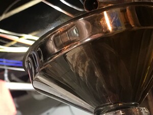

You can barely see the mist in this foto just left of the condenser output and wafting above the rim of the funnel.HDNB wrote: ↑Wed Dec 14, 2022 8:53 pmdamn, you got better eyes than me brother! would be a good tell if it's vapour condensing in the air tho.jonnys_spirit wrote: ↑Wed Dec 14, 2022 8:49 pm If you hold a light behind it so you can get a really good look is it like tiny little droplets misting out of the condenser?
cheers,
-jonny
Wondering if it’s this or similar. If it isn’t smoke.

i gotcha, i would say its def closer to mist than smoke ...jonnys_spirit wrote: ↑Thu Dec 15, 2022 6:46 am You can barely see the mist in this foto just left of the condenser output and wafting above the rim of the funnel.
Cheers!
-j
it aint smoke ...

I see that mist regularly but need to backlight / silhouette it to get a really good view of it. This is with more than adequate PC cooling. It's not ethanol vapor because the condenser is doing it's job well. It's not smoke either. It does look like a mist when you backlight it just right.
I'm not sure exactly what it is or why it's coming out of the cool end of the PC but it's normal for me if I look for it and I check for vapor leaks oftem throughout a run.
If it were uncondensed vapor I don't think it would be visible like this.
