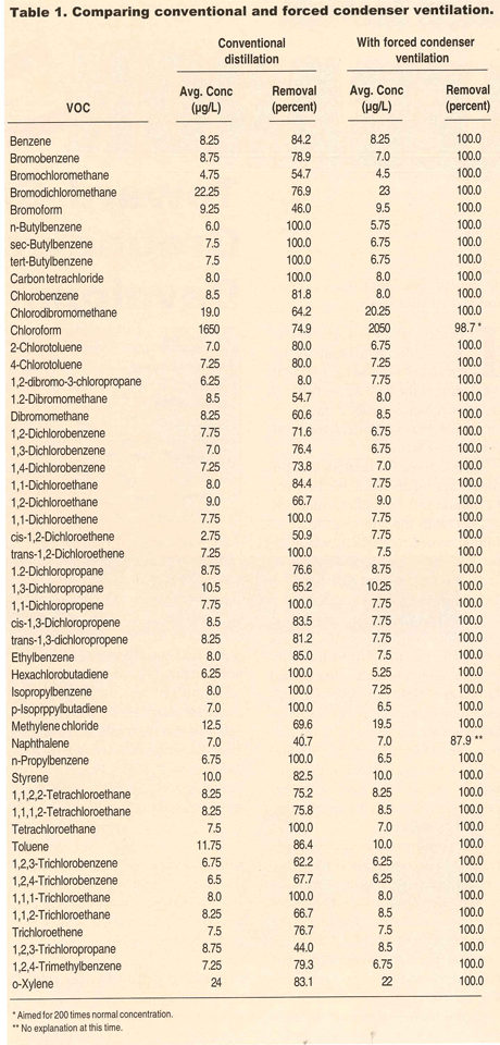

When I first saw a vent on a condenser I thought it was a vacuum breaker. I did a search here and only found on thread but that was a thread on removing air. I then ran across this article and was wondering if this was the reason.
https://wcponline.com/2000/02/15/distil ... ling-vocs/
Here was a sample of what they were removing. Not sure it applies to a still.

Well I decided to add a vent and Venturi to my product condenser. If only as a vacuum breaker.Looking at this list of what it removes(I have no clue what most of them are) I can't say they look very tasty.
So if anyone can tell me why I'm wrong about this I want to know as having knowledge is better then guessing.

Tōtōchtin wrote: Tue Sep 12, 2023 7:34 am Well I decided to add a vent and Venturi to my product condenser. If only as a vacuum breaker.Looking at this list of what it removes(I have no clue what most of them are) I can't say they look very tasty.
Tōtō Screenshot_2023-09-12-09-22-44-38_40deb401b9ffe8e1df2f1cc5ba480b12 (1).jpg
This seems like bullshit. What are you really doing and trying to do?
Edit. If you have really nasty, messed up water with benzene and formaldehyde and other really nasty shit and you are using distillation to clean it up.
if you pump atmosphere air into the column below the condenser the air will dilute the CO2 causing the pH level to rise. This will also cause some of the nasty shit to pass through the condenser and leave the water.
The other thing you can do is boil your stuff in the boiler. The CO2 in your wash will vent out the top. If you have benzene and that other crap in your drinking water you have bigger problems..
This article has nothing to do with distilling hooch. Nothing
Nothing.
Imo.

I think you are conflating two types of distilling here... the chemicals on your list are hydrocarbons and petrochemicals, if they were in my drinking, brewing or bathing water I would be getting water from another source as many of them are known carcinogens and mutagens ( caple of causing damage to DNA ) These are not chemicals that evolve in the distillation process and without reading further I am assuming your citation is actually targeted at some area of the petroleum distillation industry, or groundwater remediation.
The problem I see, might be if the condenser was overcooled to the point of huffing, this would affect the performance of the the venturi and the negative pressure that is expected at the vent. The oscillating pressure at the vent could allow uncondensed vapour to escape. Any unregulated port or " leak" on the hot side of the condenser seems like a bad design to me and the need to introduce air to the vapour path is of no benefit at all. Your drawing is not a venturi vacuum and will not create functional suction at the hole. A pitot tube in the expanding side of the venturi would work, but require higher velocity ( pressure ) flow to create the negative pressure in the expansion area of the venturi.
As an aside, while thinking about this I was wondering about the lower operating pressure limit of a steam venturi and did a search that lead to stack exchange and a similar question being posted by Manu De Hanoi a decade ago!
https://physics.stackexchange.com/quest ... w-pressure
Reading articles like this makes me think different from you Mr miller. I ran into a Tequilero who told me the same. That venting gasses produce a smoother flavor. I will run a tube to a sealed chilled glass container and taste what condenses. If it tastes like shit I will assume it is. If it tastes like my distillate I will cap the vent off.
Tōtō
