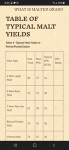

Re: First Large Batch AG
Iv been searching relentlessly for that formula. Where did you find it? And what did you search for?subbrew wrote: ↑Tue Feb 14, 2023 11:48 am some numbers I found, Corn 37 points per lb, wheat malt 39 per lb, and rye malt 29 points per lb. So total possible points 37x(14+10+20+16)+29x5+39x26= 3379 possible points. You have 57x54 gal = 3078 points conversion is 3078/3378 = 91% which is very good. Especially if you didn't grind that cracked corn.
This is all I found. Is this where u got your numbers from?
Any help much appreciated.

I pulled the numbers from brewsmith software I use for brewing beer. But a search of "potential gravity for grains" will get several hits such as this one https://homebrewacademy.com/grains-and-adjuncts-chart/Bradster68 wrote: ↑Tue Feb 14, 2023 2:25 pm
I think I got the formula from "How to Brew" by John Palmer, one of the first brewing books I read. Here is a good tutorial on calculating potential gravity http://www.backtoschoolbrewing.com/blog ... lculations
Right on. That's what I was needed.
Thanks so much.
Thanks so much.
