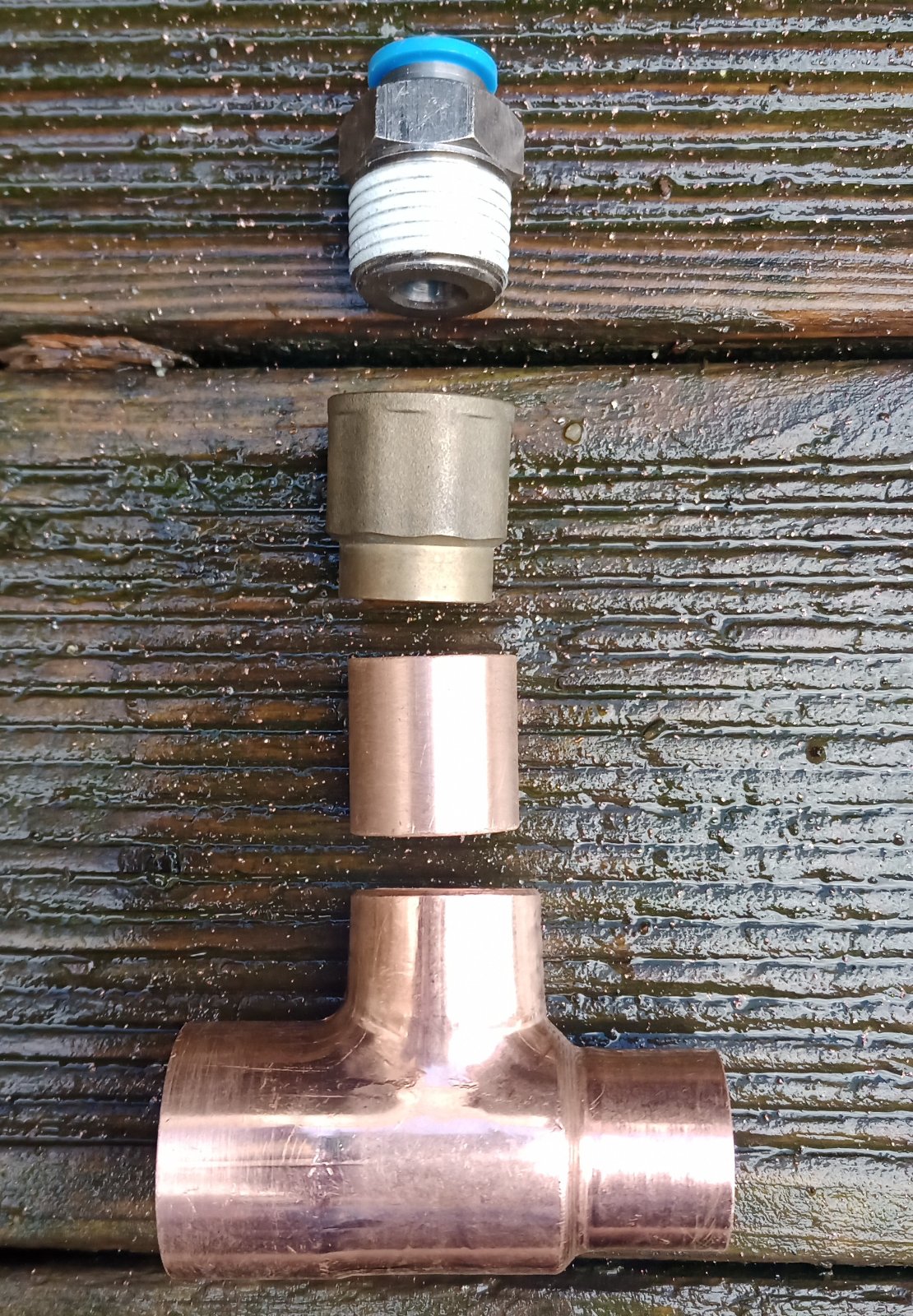

Anyway, on to the build.
It probably took me longer to clean up the dirty tubing and square the ends than anything else, as it was all rescued plumbing lengths.
28mm to 22mm reducing tee, 2 of these was my only purchase for the build.
Filed off the stop ridge in the 22mm side so that the tube can go right through.
Water connection fittings
Assembled

Full hose pressure
I rescued this fitting at work, it's half of a stainless steel valve system that failed, so I kept the Tri clamp half as I knew I would find a use for it!
I sanded and polished the 22mm copper until it was an interference fit right through the fitting. It's very inelegant and looks odd due to the sudden change in diameter, but it's an excellent way to get me into the riser!
Water connection 10mm push fit same as I use for my CCVM on RC and Dimroth PC.
I really like these as they are super convenient, very reliable and come in every size.
And that's it complete.
Went really easy, no issues at all and using the fittings that I had, there was no tricky soldering at all.
The reducing tee option does make the job easier but it's not at all necessary, I just used them as I had nothing else to buy and it suited all the other fittings that I was going to use.

The way I understand it Chris, is that restricting the flow out of the shell, will ensure that it's always full of water from end to end, and around the entire diameter. As you say I'm pressurising the outer jacket, fittings and coolant lines.NZChris wrote: ↑Wed Mar 29, 2023 11:45 am What are the advantages of putting a flow control valve on the return line?
A disadvantage is that it puts all of the fittings and hoses before the valve, including at the hot end, under pressure. There is no convenient time for a failure during a run.
Liebig hose tails or fittings should be angled down so that hoses don't want to kink when they are full.
Whereas if I were to restrict flow into the shell, with such a low input flow I could be allowing water to just take the lowest path along the jacket and never filling it completely around the diameter?
Does that make sense? It does in my head, but that's very often not related to reality!
At the moment I've got the lines going directly vertical down to the floor, where the valve is, but planning to go 90 off the fittings to neaten everything up, as suggested.

Having the valve on either end accomplishes the task.
I prefer to have the valve on the cold end of the condenser.
I'd rather touch and adjust something cool, than scalding hot.
Also, if a valve or hose fails while I'm adjusting it.
I'd rather get sprayed with cool water than scalding hot.

Something I've seen while playing around.
The closer a condenser is too horizontal, the more likely it will huff.
A downhill grade lets the liquid quickly drain to make room for incoming vapor.
Having a condenser on an angle also makes it easier to keep the jacket full of cooling water.
Ya want to work with gravity, not against it.

Air will always accumulate in the top of the jacket unless you do something about it. I put the outlet hose tail at the top of the jacket so that the jacket is always filled to the top with water.MooseMan wrote: ↑Wed Mar 29, 2023 8:16 pmThe way I understand it Chris, is that restricting the flow out of the shell, will ensure that it's always full of water from end to end, and around the entire diameter. As you say I'm pressurising the outer jacket, fittings and coolant lines.NZChris wrote: ↑Wed Mar 29, 2023 11:45 am What are the advantages of putting a flow control valve on the return line?
If the outlet is placed underneath the jacket, the water will only fill the jacket to where it overflows into the outlet.

That's true.NZChris wrote: ↑Wed Mar 29, 2023 9:27 pm
But if the condenser is placed at an angle, jacket will stay full of water due to gravity.
Even with the outlet pointing down, there will be a small bubble of air, but not enough to matter.
