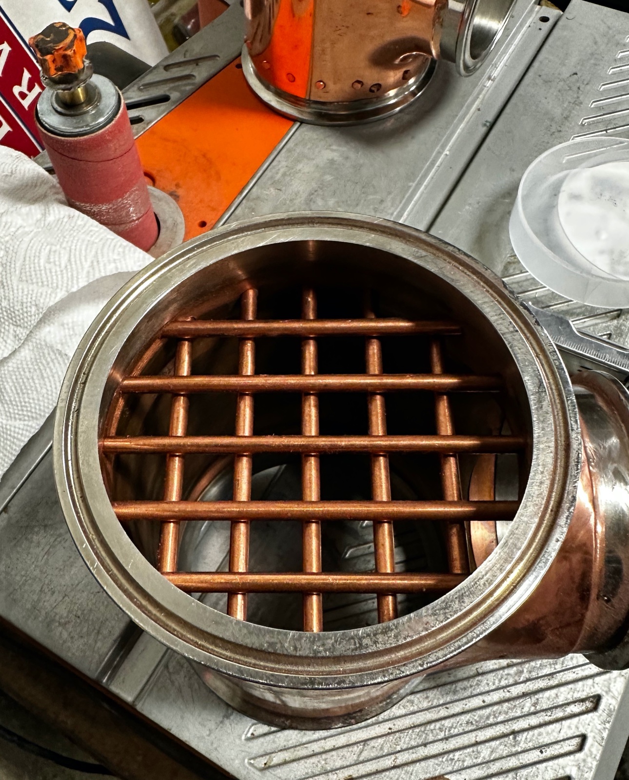

Well as long as we are on the subject of packing, let me show you what I did to support the packing.
The old still had a copper plate at the base that was extremely perforated with 3/8" holes. I had 2" of rolled up stainless mesh on top of this for the Siporax to sit on. I always felt that this was a choke point for the column to drain.
Siporax is a very through porous sintered glass and has way different performance than Rashig rings, check out this explanation.
https://www.sera.de/us/service/info/how ... orax-work/
It operates very much like large format SPP. It wants a ton of power and reflux,
My idea was to use 1/8" copper rod through drilled in the base of my bottom tees in a grid pattern. I tig welded the copper rods where they protruded. I left the welds because they reminded me of rivets and I thought it looked cool.
I made the spacing as big as I could without the possibility of the Siporax falling through. And just to complete my OCD, I will stack the first row in the vertical. This probably isn't needed but I figured it couldn't hurt and I am really trying to prevent choke points.

I drilled into the bottom of column #1 dephleg. I than took a Sioux Chief stub out https://www.siouxchief.com/products/sup ... pin-closed and through drilled it at 11/5, 12/6 and 1/7 o'clock with 1/8" holes. I put a 1/2" female adapter on it and soldered it into the bottom of the dephleg. This is where the the gear pump will pump to.
This should give a nice rain action for the condensate to drop on top of column #1 packing.
