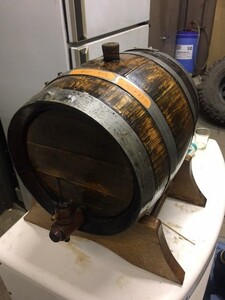

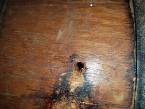

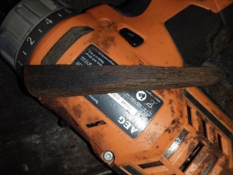

A couple of years ago I notice that one of my smaller Rum barrels was leaking. It seemed to be leaking from a very small pin hole which may have originally been a knot or other imperfection in the stave. Decided to have a crack at fixing it using what I had at hand.

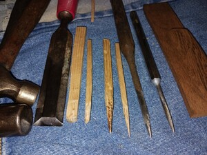

Firstly I emptied the barrel and drilled a small hole where it appeared to be leaking. The first stray chunk of oak that I found was a medium toast Still Dragon domino, I split off about 1/4 off it.
Stuck this in my cordless drill. Next I put an old rasp in my bench vice , got the drill going and ran the piece of oak over the rasp till the oak was reasonably round and slightly tapered Gave it another spin and used some sand paper to smooth things off. 006 Next job was to hammer the home made peg home. The last part of the process was to cut excess peg away and sand smooth. This repair has now been in place for quite a long time , at least two years , possibly more........no problems to date.

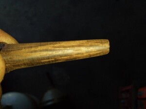

Note that the wooden spikes/ pegs used for these types of repairs are called "Spile's"

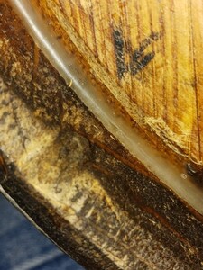

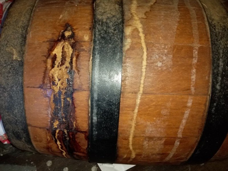

When I first saw this leak it looked like this. The leak seemed to be coming from a place where two staves met and the head and croze meet.....in short where 3 surfaces met.

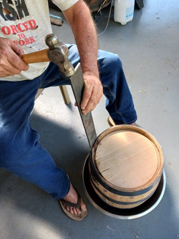

My thinking here was that if I smacked the "Head Hoop" down a little, everything should tighten up and the leak would miraculously disappear.
Some of you know that for pocket money I sell old/ antique tools ......in that time Ive found two Coopers Hoop Drivers.......some idiot sold them both thinking they would never get used
Soooo off to the shed , found a chunk of flat bar and a hammer ......turned full barrel on end , had a friend hold the bung in firmly in-case somehow it popped out when I started hammering.
Gave the head hoop a sharp tap in even spacing's around the barrel, first time around not much happened, gave it another round and the whole hoop moved a little further than I would have liked.
What was done was done, no point it going back that I can see. Note in the photo below how much the hoop has shifted, originally the hoop was flush with the end of the staves.....I just hope that in times to come this doesn't cause other problems......we will see .......and I will learn something. Once I turned the barrel back to its normal position the leak seemed even worse....but not by much.
After half an hour it had almost stopped .............................the next morning, still leaking.
100% FAIL.

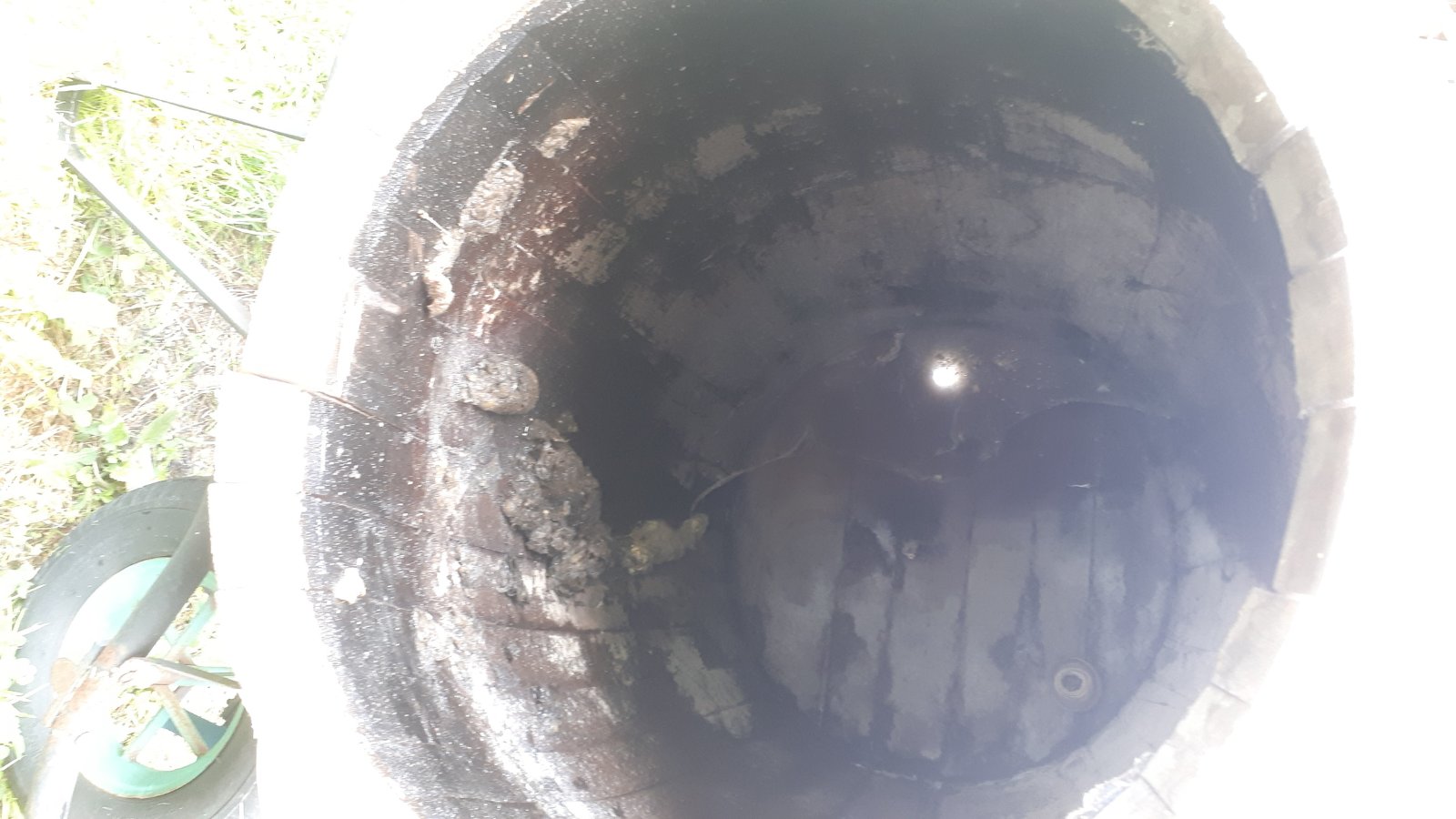

I'm currently trying to work up the courage to pull the head out a a 50L barrel.
It was given to me and has had some sort of moldish shite grow inside, I want to get the head out to give it a good clean inside.
Not sure if I should have a go or send it back to the cooperage that made it.....its a good barrel worth close to $500 Au when new.
I don't wanna bugger it up but equally I don't want to pay someone else a small fortune to do what might be a fairly simple job.
There are a few tutorials out there on taking heads out and getting them back in if you look around, pays to look at more than one.

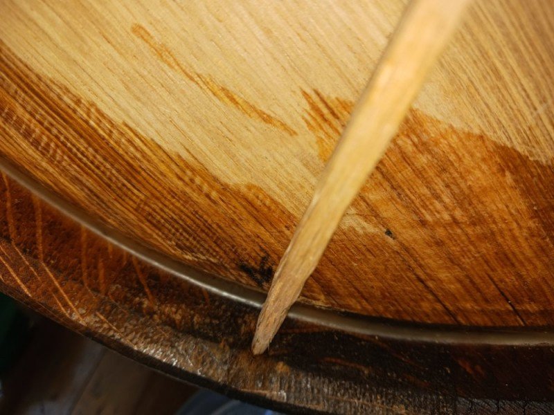

The next attempt at this leak involved bees wax and a hot air/ paint stripper gun.
I tipped the barrel on end , barrel still ¾ full, and started slowly warming the wood in the area of the leak.
The idea was to try to dry that area of the barrel at least a little bit. I did this on and off for about an hour. Next shavings of bees wax were placed in the area of the leak between the Chime and the Croze, hot air was then applied and the wax melted easily into and over the wood.
A little bit of wax goes a long way I found.
While I was doing that I also rubbed a block of dry way across the ends of hot staves to try to help with sealing those.

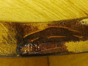

This is when things got interesting there was one small patch where tiny bubbles kept appearing and the bees wax wouldnt properly seal there.
Stopped and re accessed what was happening.
The small area that had been bubbling also turned a lighter colour than the rest of the waxed area.
Now I could see exactly were the leak was.
Another failed leak fixing attempt , but not a fail as far as leak location went. Leak area circled,.... white line below that is where I thought the leak originated.
Attempt 2

Time to get serious , made a couple of steel spikes out of an old nail punch and a pin punch.
Made them by turning them by hand on a flapper disk on a angle grinder........the oak spiles were made the same way. One of the tutorials I watched said not to drive the spile in right at the leak, to go back from it.
For that reason I punched the steel spike in half way between the leak in the stave end and the head of the barrel. I drove it in deep enough that it hit the head hoop on the outside. Pulled the steel spike out, hammered in a spile and trimmed it off. Almost instantly NO MORE LEAK.
Didnt really belive what I was seeing …...it cant be that easy.
3 weeks now and still no leak........fingers crossed
Attempt 3

Open Barrel Surgery
Back in spring I bought two barrels for fermenting cider in. Both barrels looked in good condition, but were probably dry having not been used for a few years. After having sat out since I got them home, I finally got around to cleaning up the smaller of the two (~30L) the other day. I thought it might be nice to document the process of cleaning the larger (~180L) for those who were scared to try this. This is full open barrel surgery. Not for the feint <sic> of heart!
This is the barrel as received with a few tools balanced on top. One of the hoops had come off when I collected it which is a sure sign that it had dried out somewhat. These are traditional cider barrels which were filled annually and risked drying out during the rest of the year. The hoops are fixed in place with these nails with weird eccentric heads (It looks like the body of the nail has been bent 90° and hammered flat). Clearly the nails had fallen out or been removed for this hoop.
So first step was to remove the remaining nails holding the other two hoops in place. They just pull out with a pair of pliers. Next you need to remove the hoops. The proper tool is a hoop driver which is a steel body with a flat (some times with a hook to prevent it falling off the inside of the head hoop). In the absence of the proper tool, a piece of hardwood may work up to a point. I used an old pair of all-metal pliers. Not very comfortable to use but effective. Hold your tool against the hoop and tap with a mallet / hammer. A heavy mallet will allow more control as you don't have to swing as far to get the same energy into the hoop.
Now you've got the hoops off, you need to remove the head. Use chalk to mark a point on the head and on the nearest stave (you'll notice that I didn't do this... don't do like me!). Pull on the staves while pushing on one edge of the head until it rotates into the barrel.
Now it's basically detached, you can rotate it perpendicular to the staves and pull it out. The staves will spread enough to get it out. And now you can see what you're working with.
This barrel had been used as a nest by some creature at some point. It was full of fibre glass (a lot of which had already come out when I emptied out the standing rain water through the filling hole!). That second circular shape that you can see opposite the tap hole is the start of a wasp nest. Time to break out the pressure washer!
After a thorough cleaning here it is. Give the outside a rinse. And put on a mask. If your barrel was used for anything other than spirits it will almost certainly have some kind of mold / fungus growing in it. Which means spores that you are going to aerosolise as soon as you start spraying! You don't want to be breathing that shit in! At this point it helps to orient your barrel so that the filling hole is facing down. This will make it self-draining. Once you've cleaned out the worst of it, you want to make sure that you spray each joint between the staves (which will have opened up a little) to make sure that there are no bits stuck in there which will prevent the staves fitting tightly. Also make sure that the croze (the notch where the head sits) is nice and clean.
Now for the fun part (I have no photos of this, partly because I was in a hurry, and partly because I had no spare hands. Push the head back inside. Ensure that the orientation is the same as before disassembly (remember that chalk mark that I didn't make?). Insert one edge of the head into the croze and pull it as far as you can into place without removing your fingertips. Now you need to tip the barrel up onto the open end. By pulling on the staves and swearing a lot at the barrel you can usually get the head to drop into place. Generally, the spring of the staves will stop it from falling too far. If it refuses to go, a length of copper pipe inserted through the filling hole may be used to persuade it into place. Once it's in, without too much manipulation of the barrel, you want to get a hoop on. Depending on the geometry of the barrel you may be able to stick the head hoop on first and pass the others over the top. Or you can use a loadstrap to pull the staves tight, but you may not be able to get any hoops over the loadstrap. Now you just need to tap the hoops back into place, checking that the head is seating correctly as you go. Depending on how dry your barrel is, this will be mroe or less difficult.

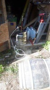

I will then steam it to sterilise and to swell the wood. I've not done that yet, but here's a pic of the small one getting the steam room treatment.
How long you need to steam for to swell the barrel will depend on how dry the staves got. For sterilising purposes you want to keep going until it's feeling hot on the outside. That way you can be sure that the inside is up to a decent bacteria killing temperature.
The little one took quite a while and a day of standing with water in it before it finally sealed up. If you have a source of clean running water (a small stream is ideal) you can dump the barrel in the water once suitably attached to ensure it doesn't just wander off. A friend did this with a similar small barrel and after a week in the stream it was tight as can be!
Hope this helps someone. Sorry about the image rotation. They're all the right way up on the computer. Any bored mods fancy waving their magic wand?
