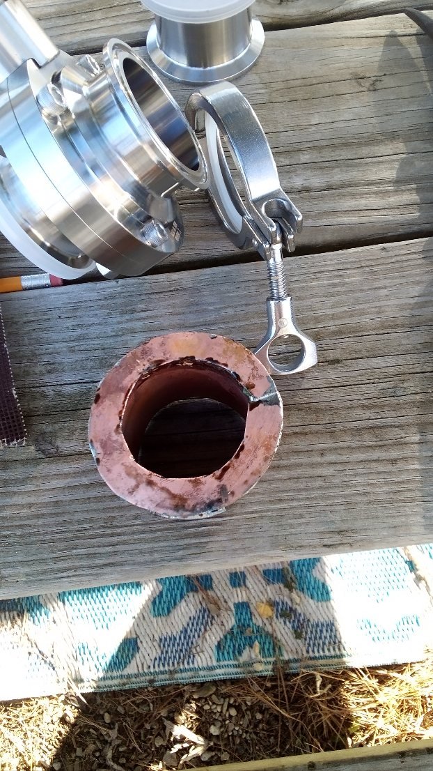

Tried to make the ferrel. I'm not real happy with the results. I mean it would work. But I think I'll just buy one. Maybe ture this one into a TC funnel. Here a picture of the mess I made trying the homemade ferrel.
Like I said it's a mess.

Not bad Wildcats . If it seals use it .

It was my first ever attempt at make a Ferrule. I think I could do better with a bit more preparation. I have a tendency to just start cutting and soldering....
I might use it... Will have to wait till my cap gets here and see how big the flat spot on top the cone is.
It does seal. I clamped it to a valve (with gasket)and filled it with water. It held. Thanks for stopping in Sir.

I mean, if it's not leaking, then you succeeded right!
If you do have another go though, try hammering one out, it's easier than you'd think.
