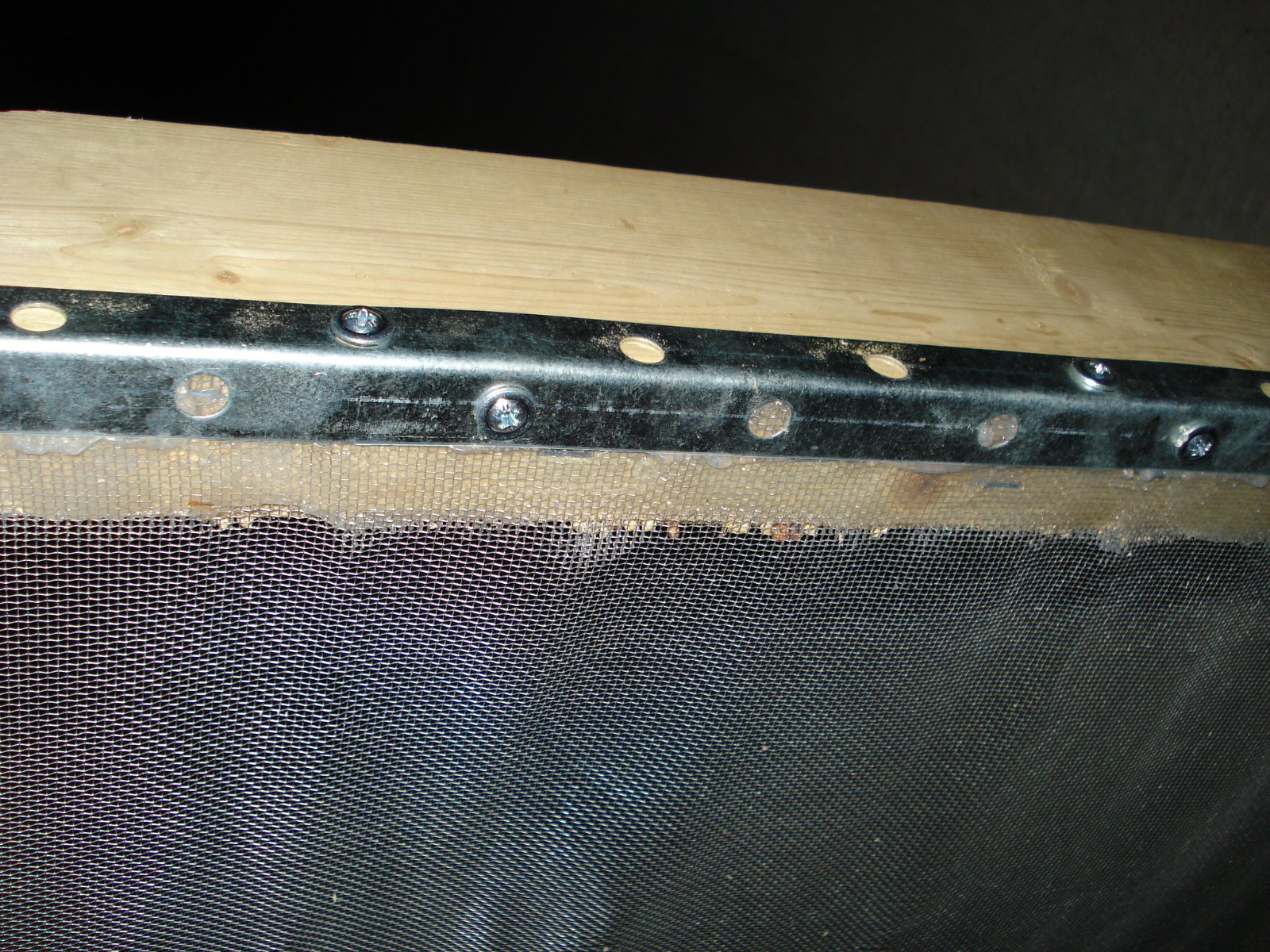

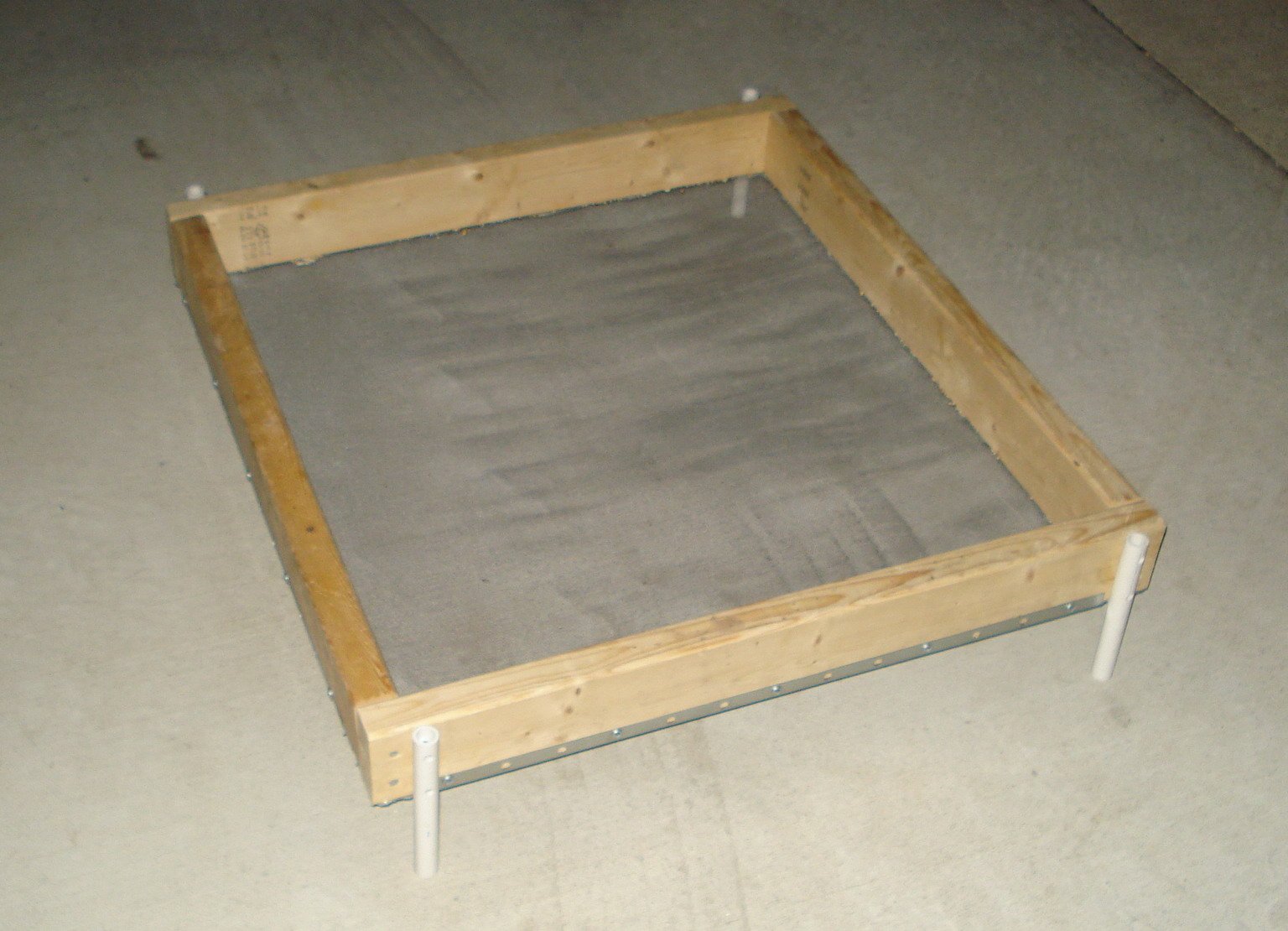

You can build a frame with a screen on the bottom. Place the wet grain on top and suck the mash through the screen.
Here you can see that the screen was first stapled to the frame, sealed/adhered with silicone and reinforced with light steel angle.
If there's any concern that the porous wood could support contamination, the wood could be coated/sealed.
