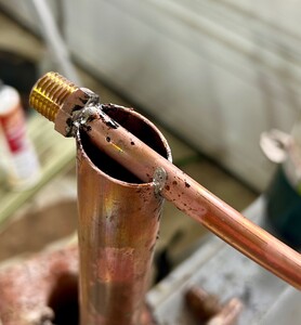

Nothing too original here, but I felt like sharing. I was inspired by a parrot built by BourbonJunkie, and finally got around to building my own. It’s a 1” pipe body and 3/8” tubing, and a 1”x1.5” coupling for the collector.
I started by drilling and flaring a hole in the coupling to fit the tubing. I had to anneal the copper to get the flare formed.

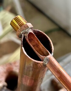

I cut one end of the 1” pipe at an angle, then cut notches in it to accept the tubing while leaving it sitting around 1/8” proud. I also drilled out a 1/4”x1/8” NPT bushing to fit on the tubing, then soldered everything together.
Once that was cooled, I ground away a little more than half the tubing inside the pipe so that liquid can flow freely between the two.
I flattened a scrap of pipe and formed a trough in it so that it fit neatly over the tubing, then soldered it in place.
Of course there was plenty of filing and sanding to clean everything up and make it look nice. The rest of the build is pretty self explanatory, but I will say it was a bit of a challenge to solder all the joints without overheating the ones I’d already done.
Now to clean it up and put it to work.

Is the valve able to be removed if needed or is it effectively soldered in place ?

Yummyrum wrote: Thu Apr 03, 2025 1:00 pm Is the valve able to be removed if needed or is it effectively soldered in place ?
Yes 8)
It’s captive, but not soldered. If I need to remove it, I could cut the outlet pipe and unscrew it.
