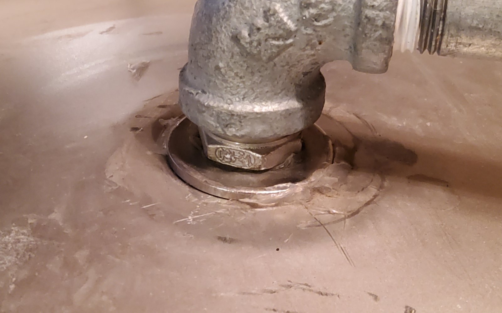

I can't believe this. I picked up a used keg and after getting home I noticed the bottom drain was loose. The silicone had started to come off ! Some people have no clue and if that wasn't bad enough it looks like galvanized was used as well. What a good way to change this out? I was thinking of with a SS weld spud soldered in place. Also any ideas on how to add some legs?

Yeah that's definitely galvanized and needs replaced.
Here's a topic that covers a bottom drain as well as adding swivel caster to the base of the keg.
When I do bottom drains on kegs, I use 1". I tried 3/4" in the past, but it was smaller and slower than I prefer.
