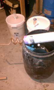

this works good with ice in the middle

i cant exactly tell if that is a flake stand or what, but i assure you if i cant keep 70 gal cool during a 4 hour run... then just adding some bottles of ice aint gonna do it. like i said i think i may have the solution i just cant share until i know it works and that may take a week or two of searching for partstoast860 wrote:this works good with ice in the middle

its just a coil in the middle of a pvc pipe. I drink a lot of mt dew and reuse the bottle. I freeze them and take them out the freezer as needed( help conserve energy in the freezer ) but I put a gauge in the water bucket and watch it . when it hits 80 degrees I throw 2 bottles in the water. let it melt a little then cut it out. leave a nice cylinder that fits in the middle of a coil. when I used it a lot i was using a 5gal bucket for my water . in a 4 hour run i kept it pretty steady... i just make the outflow run thru the coil it cools down while it runs thru the coil by a lot. now i just use a big Rubbermaid thing... if u use one just make sure u duct tape the outside to keep it from flexing to much and breaking when u empty it ..

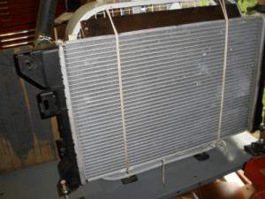

I have been running my radiator cooling system all this summer without a hitch. It cools the water just fine for as long as I want to run the still. Stripping runs or long spirit runs, it dont care. First, I got a fair size radiator that was damaged in shipping(broken tab).The radiator holds about 2 gal.
Then got a dishwasher pump that fits the lower hose connection just perfect with a short hose and 2 clamps.
Next i laid a 20 IN. cheep box fan on it and secured it with cord. Set it up and made 2 legs for it to keep it up right. The pump pulls water from the lower radiator connection feeding up to my valves to send cooling to my upper coil condenser or to my liebig condenser, then right back over to the top radiator connection back into the radiator. The water is hot going in (150F and 90F) and warm coming out.
I have it mounted about chest high on a metal shelf. There is virtually no noise. I run the fan on the lowest speed.
I have a 7.5 gal. SS boiler, gas fired with a 40 inch.high ....2 in. copper boka tube with off-set head and valved reflux return. 2 valves to send cooling to either or both condensers. Spirit runs I dont use the liebig at all.
It is my final solution to cooling water on my stilling set up. Dang, I tried all other methods first. If you set your mind to it, its easy and neat looking too. Just start looking around for the parts like i did untill you have enough to start building
There is no more to it than that.

Re: Swamp Cooler "huh yea sure" NOT!!!
Just ordered the radiator, got a fan to attach it. This should help. I don't want to run my hose to the condenser anymore, I wound up using way too much water to cool things off.

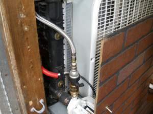

Thats what moved me to do the radiator cooler. I was using city water abd wasting 25 to 30 gal, of water each run at least. Plus I had to keep a barrel
I have a cork placed in the fill hole of the radiator with a thermometer in it. I have to add water every 2 or 3 runs, because of evaperation.
When you cut the thing off, water will drain from the still and overfill the radator so keep it about a quart low. The small tube that was meant to go to the resivor is pluged with a rubber cap.
I had red food dye in the radiator to make sure i had no condenser leak as it would show up in my jar if that was the case but it didnt.
The system is open... and the radiator must be upright for it to work. Hot water in the top and as it falls in the radiator , it cools and is pulled from the lower hose connection back to the still.
I suppose you can rig any type of pump to the lower hose connection but the dishwasher pump just fit perfect and makes little or no noise and pushes the water just right.
Ok also I took and old 28000 btu window unit separated the evaporator and
Put it in the holding tank I put the condenser in another holding vessel so the garage didn't get hot. I can run slowly about four hours them the water gets to 105 my pump is not designed for
That hot of water so I add ice or frozen dew bottles of
I run any longer
I run any longer
