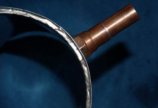

My condenser for my big rig is quite a nice condenser. It is a double walled cylinder with a input to the inside of the two walls at the top and an outlet at the bottom on the opposite side.
The dimensions are 400mm tall by 250 diameter with 6mm in between the walls.
This gives a cooling surface of 0.62 square meters.
This is the equivalent to 12mm tube 16.5M long.

It was not too difficult but not trivial either. First I made the outside cylinder to the given diameter. I drilled and sawed the holes for the input and output respectively, and soldered in the tubes. The tubes were flared to make a snug fit once inserted from the inside. Then I made the inside cylinder to spec. I turned out the top and bottom edge, perpendicular to the cylinder wall, so that the diameter of the edge was the same as the inside of the outside cylinder. I slid the two together. This was a bit difficult because I had the tolerance a bit snug and had to pry the edges past the tubes. Once I got it slid in, I fluxed and soldered the edges to the outside cylinder. I then pressure tested it with 15 psi and soapy water.
The tricky part on mine was mounting it to the inside of the canister I made. The canister is sealed so I had a couple of tries getting everything leak proof.
