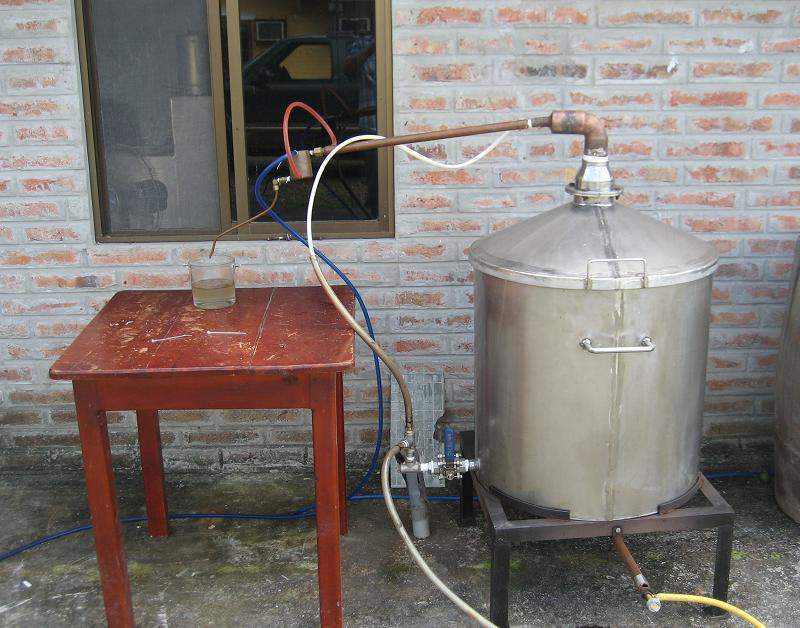

Today I made the first run with a special designed boiler for extracting essential oils.

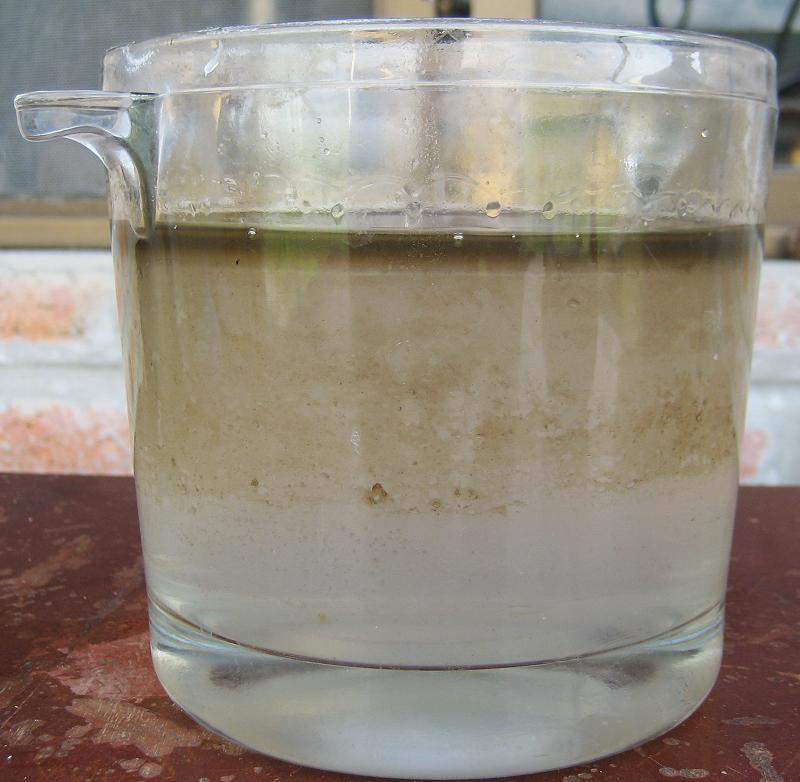

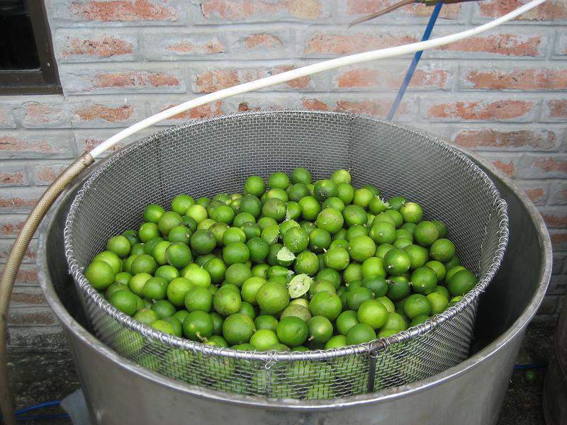

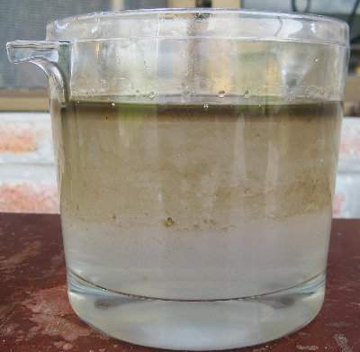

I loaded it with 50 Kg of third class quality lemon (own harvest) and got a reasonable quantity of oil out. :D
It's in the freezer now to separate it a little more from the water.
I had several leaks in the lid of the boiler, the material to screw it together didn't arrive yet.
I used highest power with a big 80.000 BTU propane burner.
Any comments wellcome.

lemon in basquet
lemon in basquet
Still setup
Still setup
oil/water mix
oil/water mix

I throw the complete fruits in because I was too lazy to peel 1500 limes and staffs where busy with other work.
