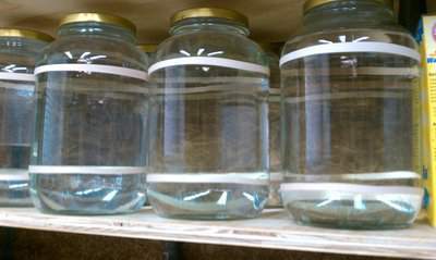

I Have to date 30 large mouth gallon jars. I'm Going to make a bunch of tapered bungs to fit inside due to the lid being metal with a synthetic lining not to mention they reek of the hot peppers that originally filled them. My question is can i use a softer wood such a poplar or should I use white oak. Its not my intention for the lid to impart flavor, I have a good supply of both American and European white oak spirals for that. I was thinking popular being a softer hardwood would be easier to work with. Are there any characteristics of poplar that would impart off flavor to my spirits? Could i use a softer wood such as pine and get more evaporation?
