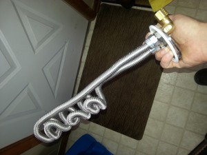

So this is my solution to add more cooling capacity. But Question, should one run the "coldfinger" as well as the add on coil?

I would forget the cold finger, unless you need it to supplement your new coil. But in that case I'd prolly make a bigger coil. You've got lots of unused space and making a continuous coil would get a lot more surface area per length if you need it.

can't make a continuous coil with that silly coldfinger in the way. There's 60" of 1/2 corrugated tube in the way I have it.skow69 wrote:I would forget the cold finger, unless you need it to supplement your new coil. But in that case I'd prolly make a bigger coil. You've got lots of unused space and making a continuous coil would get a lot more surface area per length if you need it.

If 60 inches of 1/2" CSST isn't knocking down your vapor, you need to take your power bill into consideration.....

LOL. So that's why you made that crazy curlyque kinda shape. Ya, 60" ougthta do it. Let us know how it goes.Getsmokin wrote: can't make a continuous coil with that silly coldfinger in the way. There's 60" of 1/2 corrugated tube in the way I have it.

It works great! More like what I was thinking a reflux condenser should do. I had plumbed the factory rc in with the added tubing, that didn't work very well. So I completely disconnected the factory tube and just run the corrugated tubing. Will knock down 4000 watts with almost no coolant flow!skow69 wrote:LOL. So that's why you made that crazy curlyque kinda shape. Ya, 60" ougthta do it. Let us know how it goes.Getsmokin wrote: can't make a continuous coil with that silly coldfinger in the way. There's 60" of 1/2 corrugated tube in the way I have it.

Glad to hear it, man. That was a long road you had to travel. Your stainless curlyque still cracks me up.
