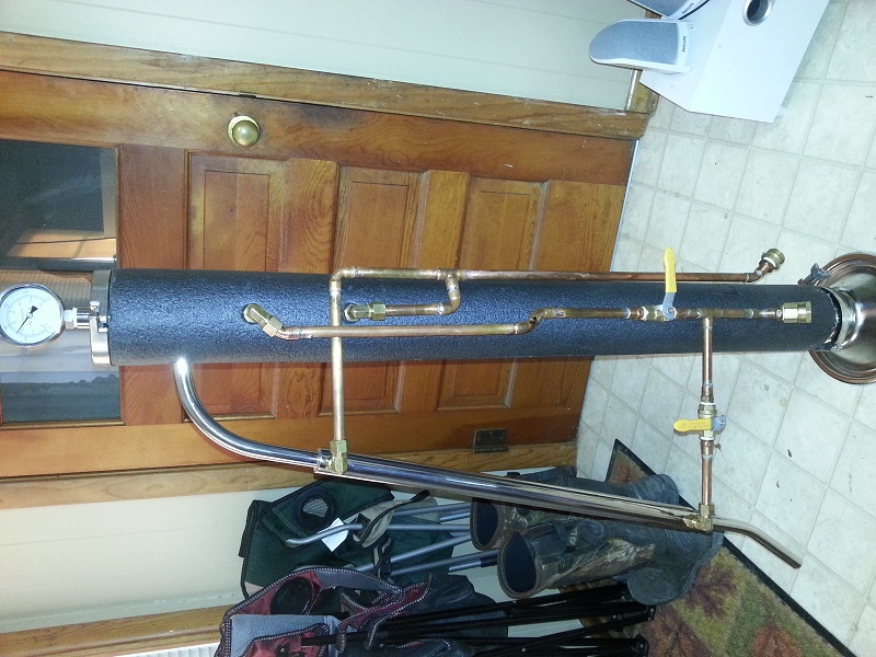

Don't know what they look like, got any detailed pics?. from the Web site they look like a jacketed condenser?. I've always done in the bottom out the top. Everyones different. you will need a valve to run it, so if you put cold in the top then exit the bottom, just put the valve on the bottom to hold pressure back to keep the condenser full.

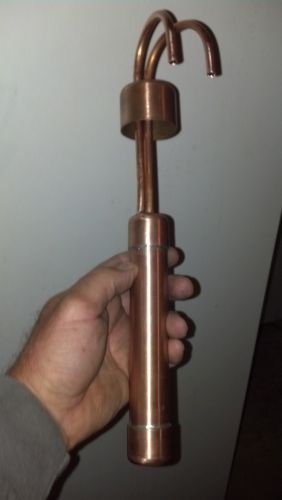

Interesting discussion as I just made a coldfinger for my CM and have been wrestling with this subject.
My first inclination would be to fill at the bottom due to the lack being able to properly purge air from it if filled from the top. While thinking about it this morning I realized that since my cooling lines to the coldfinger are simple plastic tubing I can simply cross them, fill from the bottom until the air is purged, close the valve and swap the lines to fill from the top if that makes more sense to do so. Filling from the top would make more sense when considering shock cooling.
Discussion on mine is here: http://homedistiller.org/forum/viewtopi ... 87&t=51586

googe wrote:Don't know what they look like, got any detailed pics?. from the Web site they look like a jacketed condenser?. I've always done in the bottom out the top. Everyones different. you will need a valve to run it, so if you put cold in the top then exit the bottom, just put the valve on the bottom to hold pressure back to keep the condenser full.
There, finally got them to load.

T-Pee wrote:Interesting discussion as I just made a coldfinger for my CM and have been wrestling with this subject.
tp
It looks like on your coldfinger if there was a small air bleed hole in the top of your outlet tube purging air wouldn't be a problem with top to bottom flow.

ThAnks or the pics!, I agree, the blue looks cool!. The condenser looks small for the column size, do you know what diameter it is?. Do the coolant lines screw into the column?, I've always wanted to try it that way instead of soldering them in. Have you run it yet?, does it hold full reflux ok?. Sorry for all the questions, like learning how manufacturers do what they do as they don't usually share freely.

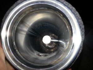

googe wrote:ThAnks or the pics!, I agree, the blue looks cool!. The condenser looks small for the column size, do you know what diameter it is?. Do the coolant lines screw into the column?, I've always wanted to try it that way instead of soldering them in. Have you run it yet?, does it hold full reflux ok?. Sorry for all the questions, like learning how manufacturers do what they do as they don't usually share freely.
it's a bit under sized at 1"x7" . Its fully welded in (I wish it wasn't) with compression fittings to copper on the outside. I have gotten full reflux out of it, but it's a bit touchy. I have just reversed the rc flow from bottom to top to top to bottom in hopes of getting the tails to compress.

Just finishing up another run now. Have to say that 1"x7" condenser in a 3" tower is not even close to being big enough! I'm really starting to feel like i get more reflux from the 4' packed column than this dinky thing.
