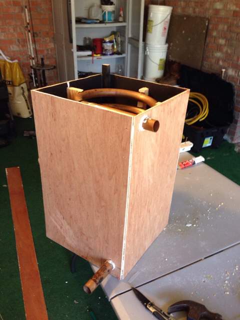

Well I about got me a box finished

My first attempt at a box is a flop, that piece luan just won't hold water, I got some 1x6 I will try again

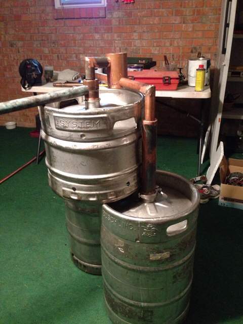

Thats a wild boiler setup faste. Is that a double 1/2 barrel piped together into a 1/4 barrel thumper? How do you heat the 2 1/2 barrels?

Yeah man it's a beast. I have a double burner it sits on quite nicely. Just have make sure it has equal amounts of mash and heating at same rate. But for stripping it works good

Line the luan box with a nice thick black garbage bag. Once full of water, it'll look pretty decent.

I hate to b a dick but I think I gota steal your double keg boiler and keg thumper idea that is bad ass my man!

Try painting the inside of your box with RedGard
http://m.homedepot.com/p/Custom-Buildin ... 5yc1vZba6w" onclick="window.open(this.href);return false;" rel="nofollow
This product really works good and will make that wood water tight. I would also use a bulk head fitting where the copper penetrates the wood
Good Luck

yea paint the thing with waterproofing. lowes sells one that is blue .. much thicker then redgard. but either one with make is waterproof. paint it from the outside. like 3 coats and you will never have a problem..

Hey drunk did you ever try and build 2 into one?drunk-pat100 wrote:I hate to b a dick but I think I gota steal your double keg boiler and keg thumper idea that is bad ass my man!
