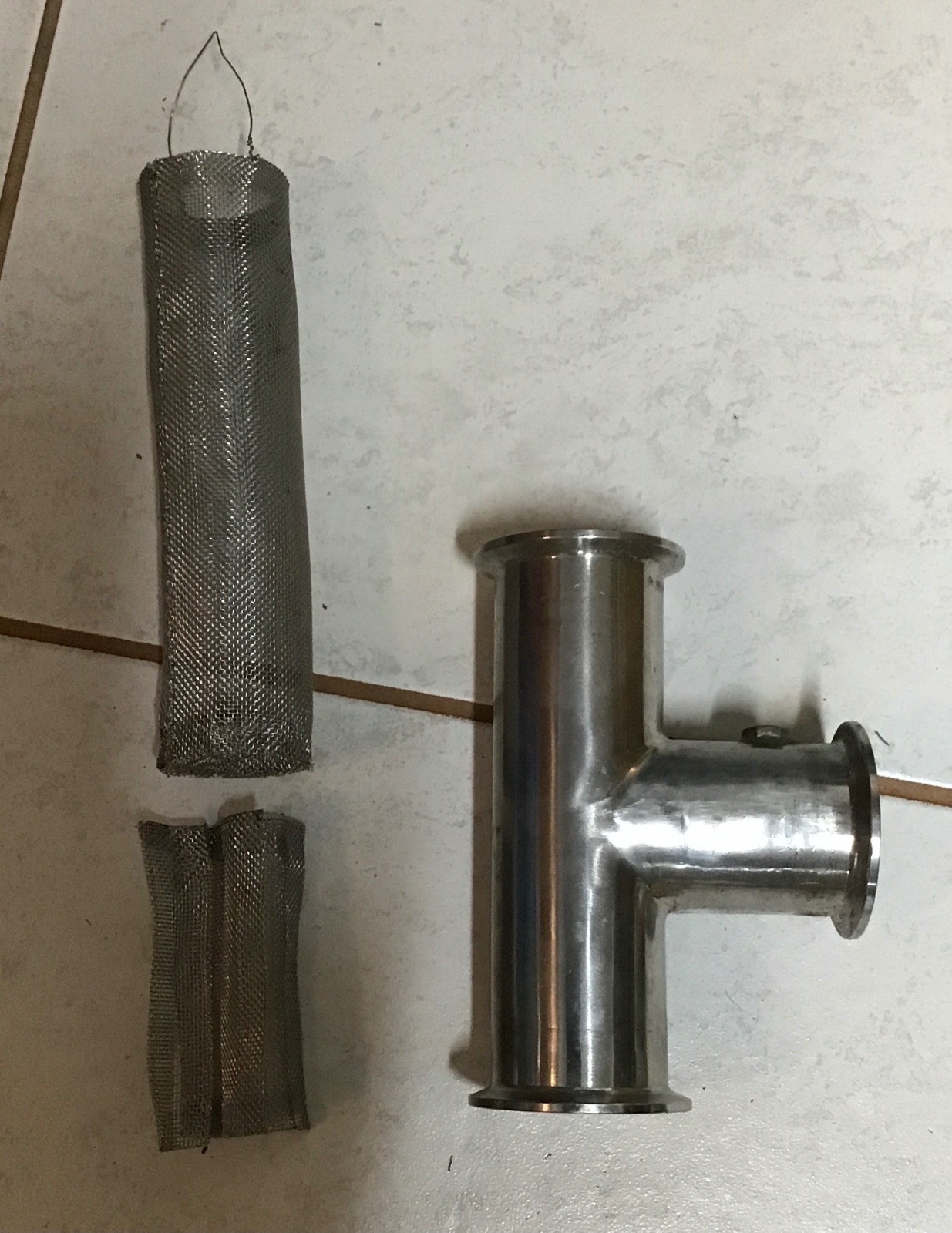

What are the half-round clampy things called and where can I get some, please?kimbodious wrote: ↑Sun Jun 12, 2016 3:41 am Anyway now I have my own construction set to play around with!
kimbodious
- Posts: 1223
Re: Adult's Meccano Set
The clamps are mostly referred to as triclamps, mostly ebay from China but also locally from StillDragoneStill wrote: ↑Sun Sep 01, 2019 2:15 amWhat are the half-round clampy things called and where can I get some, please?kimbodious wrote: ↑Sun Jun 12, 2016 3:41 am Anyway now I have my own construction set to play around with!

gday Kiwipete2
No probs about the question.
Good observation. I made a little stand out of left over SS mesh to hold the bottom of the basket just at the top of where the vapour enters the chamber. This also serves to keep the basket up away from any condensate that comes from passive reflux.
The 2” tees are really too narrow for a decent-sized basket. It would be great if you used 3x3x2” tees. I just worked with what I already had.
Modular 2" Pot Still
kiwipete
- Posts: 12
- Joined: Sat Mar 19, 2022 2:19 pm
Hi Kimbo,
That makes perfect sense now.
Whilst thinking about it, I came up with a super minimal alternative (and cheap.. ): Have a mesh washer / seal between the two Tees, so the top Tee functions as the container. Downside would be that you can't swap botanicals in mid stream like you did in the earlier post.

I swapped baskets out the top of the chamber. My stand was way fancier than it needed to be, a simple stool of a couple of loops of SS wire would be sufficient. I would try and make the baskets as long as required for maximum exposure to the vapour.
