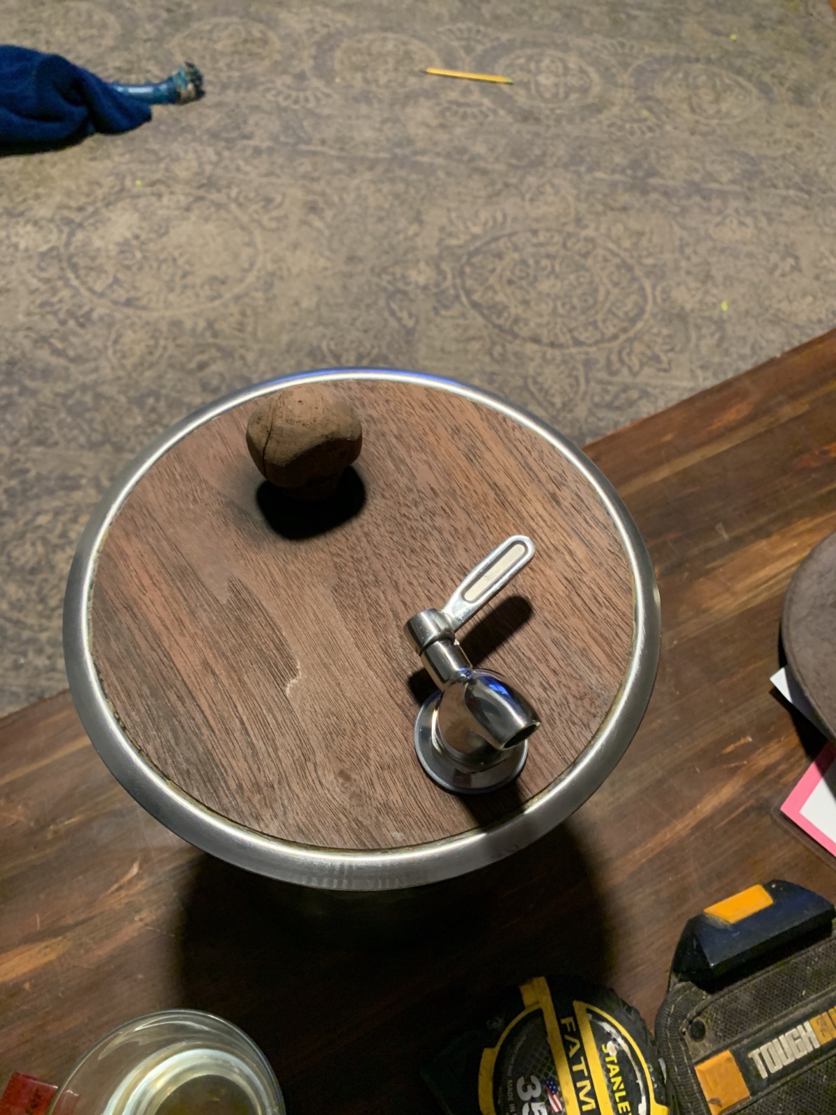

@Badmotivator Thanks for the barrel. It is top notch construction. I really like the spigot. No leak from that guy! Have you thought of grinding a small flat on the lower rim so it doesn't roll around? I set mine on a wooden holder from a old wooden barrel I had. I will sure like the "no leaks" from the quality construction. Just a suggestion.

One thing that worried me with mine was something snagging on the valve on the spout or bumping it and it start dripping. So I drilled a small hole in the handle of the spigot and lockwired it to the lip. Which of course also provides a tamper proof "seal" if you will.

Thanks for the tip. I would think lowering the head end or raising the rear, would keep the liquid in contact with more of the oak. Raising the rear it is. I will come up with something fun. Cheers.jonnys_spirit wrote: ↑Fri Oct 07, 2022 11:58 amNice hack!subbrew wrote: ↑Fri Oct 07, 2022 11:43 amIn the mean time if you cut a slot in a wine cork and slide it on the rim of the baine marie it will keep it from rolling.

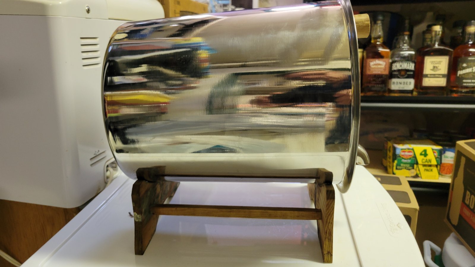

Something like this only the head end shorter to keep the wood saturated if the barrel isn't completely full. The Bain-Marie's are tapered a bit with the head end being slightly larger. I wonder if just a cradle on the back end would be stable enough. May be if it had a flat foot on the bottom. Just throwing out some ideas.

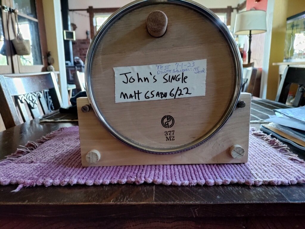

Here is what I did
